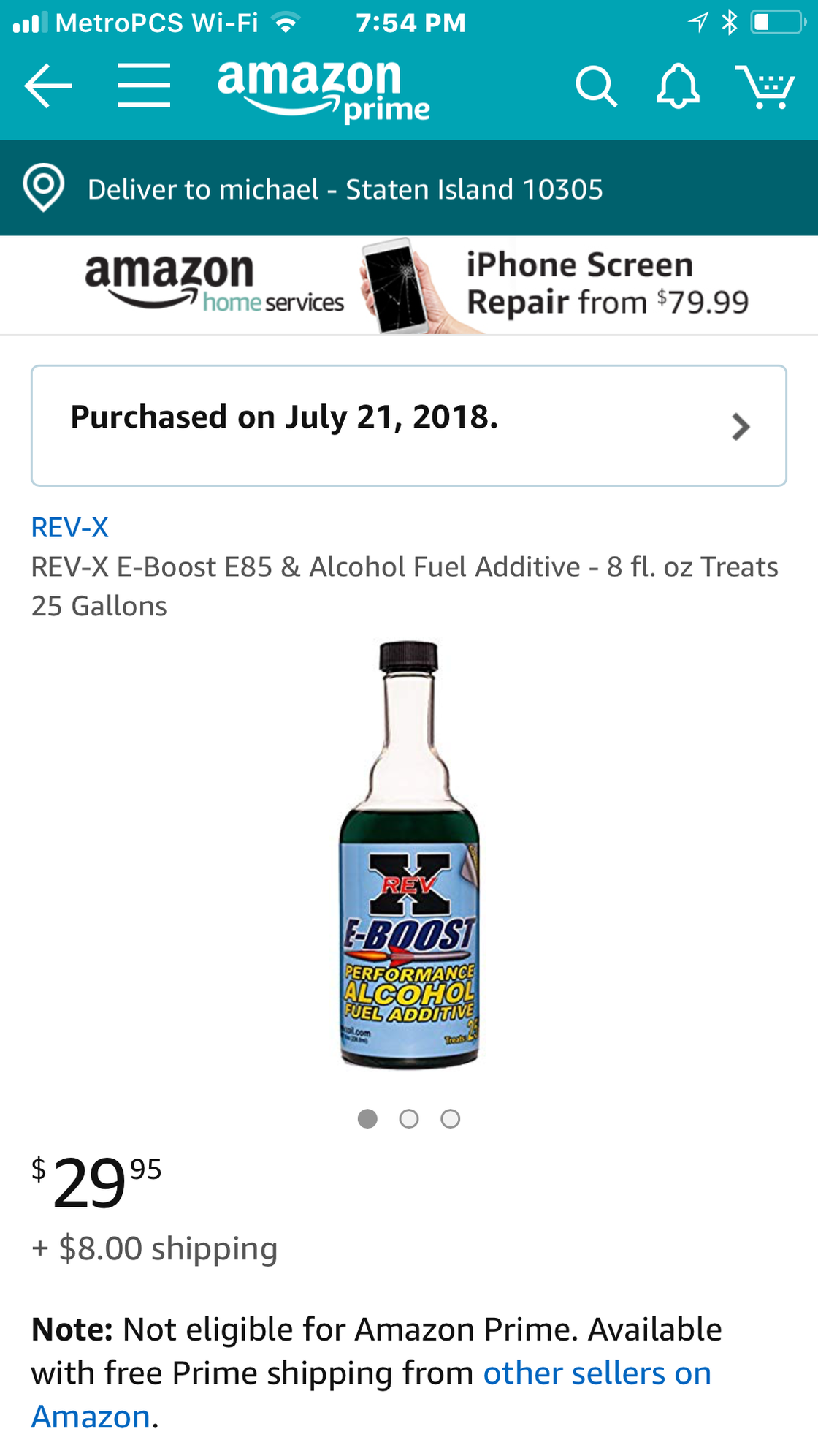

Originally Posted by speakerfritz
I’m using it to cool engine, increase power, keep combustion and exhaust system clean
i was using a 30% mix due to concerns with corrosion propensity when using 50% or more...but since I found these corrosion /lube additives for alcohol burning engines and they indicate it works for methonal, I upped my mix to 50%.
i switched to this one....it mixes much better with the methanol.
