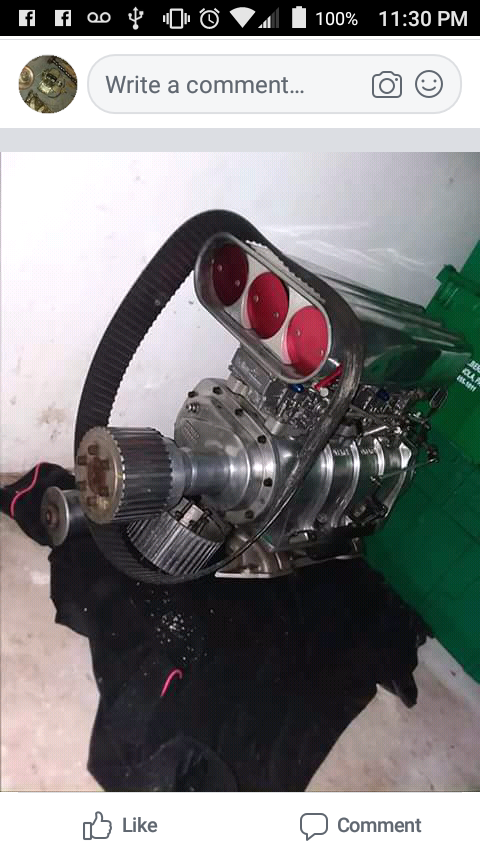

Thread back from the dead! This is something I'm going to try very very soon as I have lucked into a deal on a Dyers Blower for $1200. E85 will be a must for me as I am running Autotec pistons (1000773) with an engineering change to 1.71 for zero deck and with heads milled and cc'd to 73-74 it'll be close to 12:1 static. (18:1 with blower)

Reply from dyers hmmmm guess I'll put out feelers on cranks
