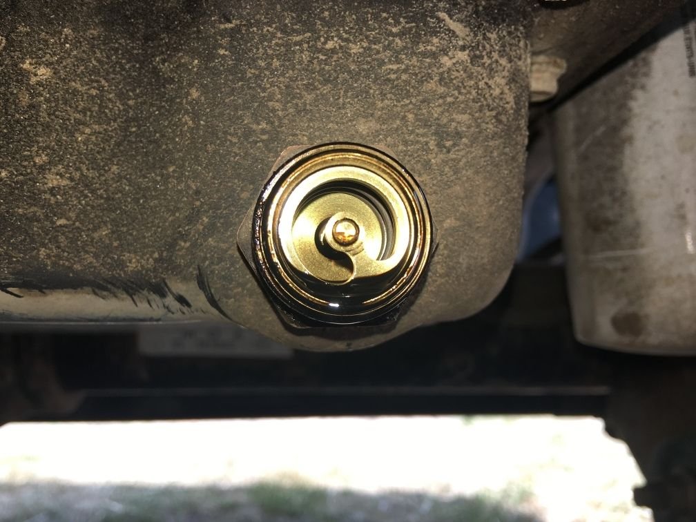

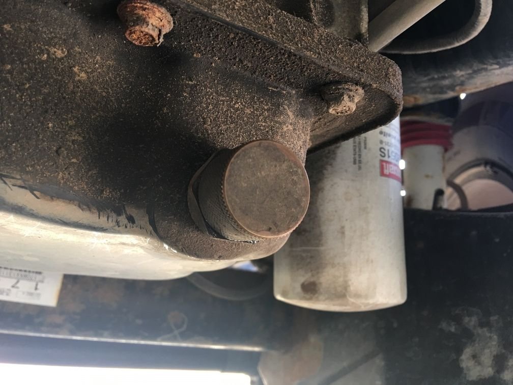

Long time lurker/reader and did ask a bunch of questions when I had a ‘04 F150. Now I have a 2013 F350 Platinum with 6.7l and I absolutely love this truck. I ran into a bit of a problem when I went to change the oil the first time. My oil drain plug is clearly not standard as you can see from the pics. I ended up taking it to a mechanic so they could change the oil since we were heading out west and I didn’t want to mess with it. Can anyone tell me what this plug is and if there are some parts that I need to buy to be able to change the oil myself in the future? Thanks in advance for any help.

My guess it's aftermarket quick drain, probably a quick connect hose that goes with it ???

You can remove it and install an EZ-Drain or Fumoto plug for easier oil changes. if you with either of these, get the 90* turn down.
Or you can go to parts store and get a stock drain plug.

Thanks for the replies. I didn't get any parts with the truck when I bought it so I'll have to change the plug to that Fumoto 90*.
