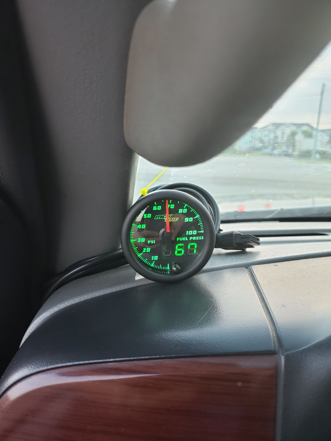

Fuel Pressure Gauge
Got a fuel pressure gauge installed. I went with the Max Tow gauge due to the price point and I think it looks pretty good. I haven't gotten a cluster for it yet as I'm not sure what other gauges I might want to install. Pressure is 67 at idle, it will drop two pounds when i step into it so not bad. It looks like the truck already has a blue spring kit installed.
A few notes from the install for anyone who comes across this in the future.
--get the adapter that allows the sensor to be installed into the fuel filter housing. I didn't realize I should have ordered that and had to wait for it to get shipped.
--I used yellow Teflon tape to install the sensor into the adapter. The adapter itself uses an o ring to seal. I've read yellow tape is appropriate for fuel.
--Fuse taps make it so you don't have to cut into any part of your harness. They were pretty easy to use after I watched this video on YouTube (
) and checked the fuses to see which ones cutoff and where the hot side of the fuse was. I don't remember which ones I used but can look it again if it will help somebody. Only bad thing about using the fuse taps is the fuse box cover won't fit back on - I'll have to cut some of the plastic or something.

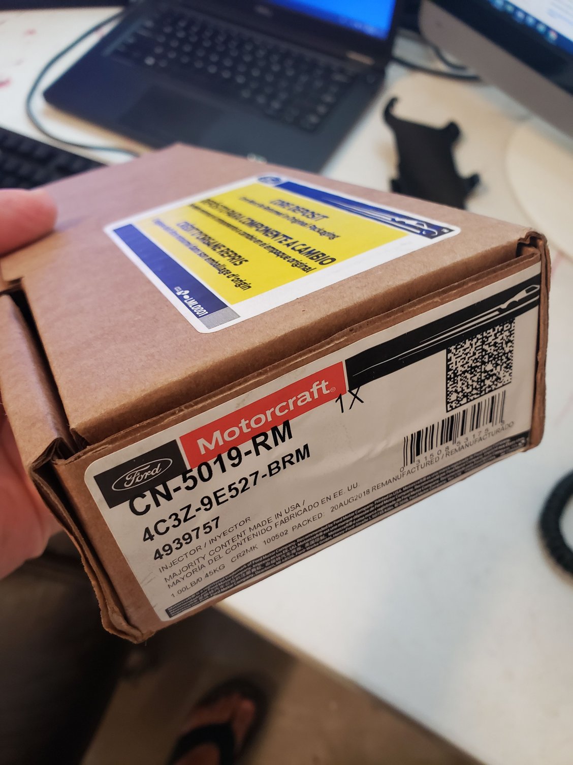

Injector box from Rockauto. Looks like Ford Motorcraft
​​​​old injector
