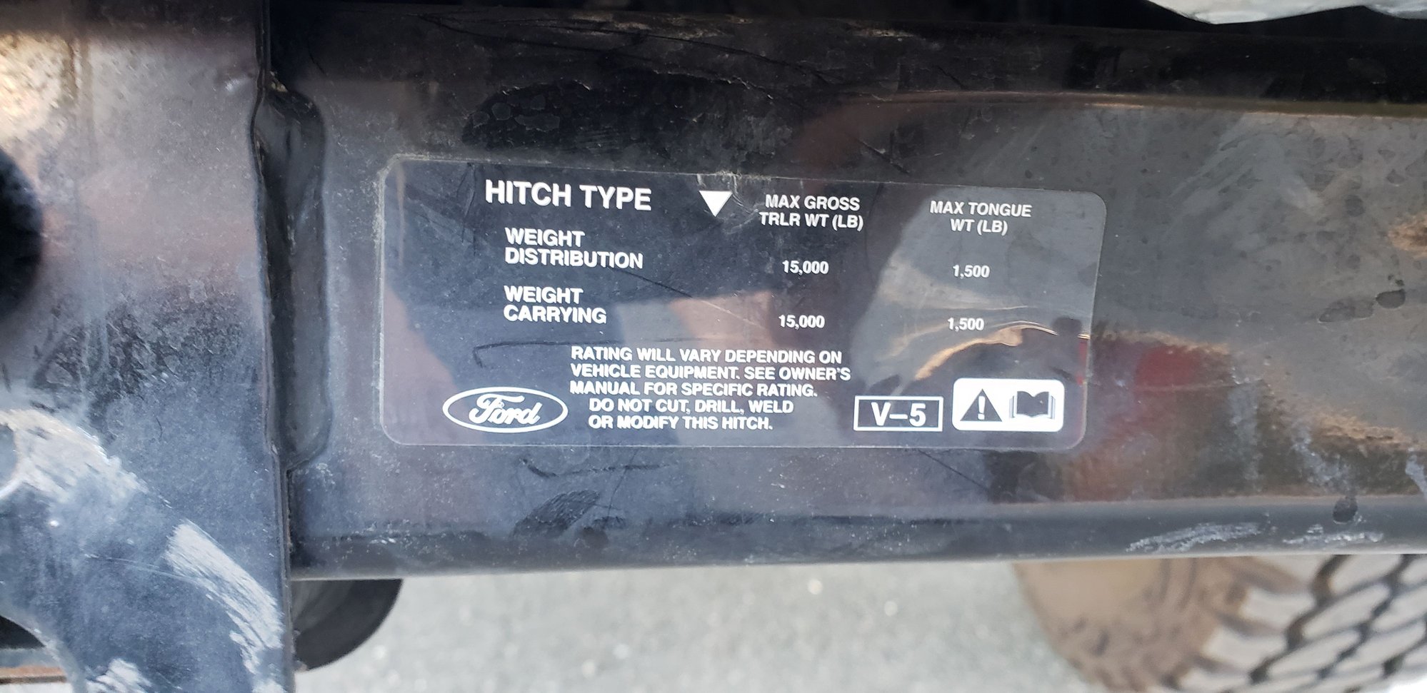

My F250 came with a class 5 hitch. It says 1500lb tongue weight cap. Come to find out my travel trailer has a 1450lb tongue weight dry. I am guessing I have up to 1000lbs of stuff and if my tanks are full (driving to dump station) then I am calculating near 2000lb tongue weight? How bad is this? Do I need to upgrade immediately? I have yo go dump once a week. I am full time boondocking at the moment.

It's the other way around. Diesel has a higher tongue and tow cap. I am not worried too much about actual tongue weight. It's 1800lbs and I have air bags anyways. I am just worried because the hitch itself is only a 1500 lb Max Capacity.
Copied from Fords 2017 Brochure:
F-250/F-350 Super Duty SRW 15,000 1,500 15,000(2) 1,500(2)
F-250/F-350 Super Duty SRW w/6.7L engine 18,000 1,800 18,000(3)(4) 1,800(3)(4)
F-350 Super Duty DRW w/6.2L engine 16,700 1,670 16,700(3) 1,670(3)
F-350 Super Duty DRW w/6.7L engine and F-450 Super Duty 21,000 2,100 21,000(3) 2,100(3)
(1) Hitch receivers do not include a hitch ball or ball mounting. You are responsible for obtaining the proper hitch ball, ball mounting, weight-distributing equipment (i.e., equalizing
arms and snap-up brackets, sway control system) and other appropriate equipment to tow both the trailer and its cargo load. (2) Not available with 6.7L diesel with 176" wheelbase.
(3) 3.0" receiver. If the provided 3.0" to 2.0" adapter is used, this reduces the Max. Trailer Capacity to 15,000 lbs. and the Max. Tongue Load to 1,500 lbs. (4) Available only with 176"

My solution... only $238 shipped. MUCH beefier then the stock hitch. Made it feel like tin foil. 😁
I know it doesnt legally change the ratings but I have Firestone helper bags so I am not worried about being slightly over my trucks tongue weight rating.
