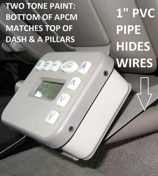

The blunt cut wires go to the aftermarket equipment being controlled (Chelsea or Muncie hydraulic pump or what have you).
That is because Cleatus12r has the fancier (actually, the fanciest) of the three different versions of Auxiliary Powertrain Control Modules (APCM) idle control boxes that Ford made for the 7.3L.
There is an extra "PTO CONTROL" button on the fanciest version of APCM that allows it to control the aftermarket equipment. That button is on the left hand side of the APCM.
The APCM that Cleatus12r has in the marketplace is identical to this new in box one shown in the photo immediately below that I ordered as original equipment on a 2003 F-550 (7.3L), so Cody I believe you can expand the model years covered in your listing to 2003 (7.3L).
On the other hand, the APCM that I have in my older 2000 F-550 is the original version, without that extra button, and without as many extra wires. (Disassembled, painted to match, reassembled)
There is a third version of the APCM that has even fewer buttons and less functionality. I don't have any photos of this bargain basement version, but I saw many of them on E-Series cutaway based airport transport busses back in the days when I flew four days a week. I doubt many passengers on those busses noticed that the APCM had fewer buttons... which was a good sign of their stable mental health. Not such a good sign for me, however.
