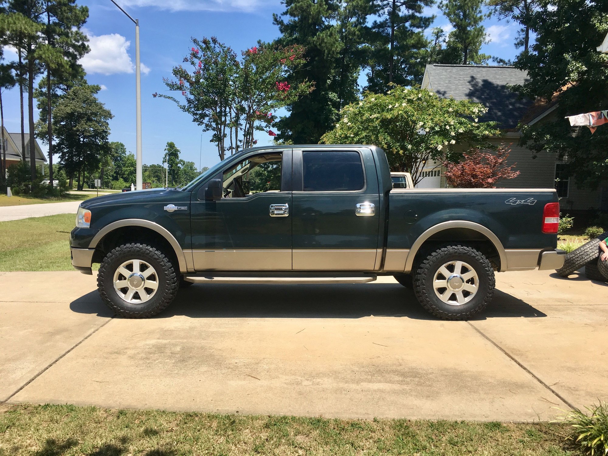

I have gone through a lot of threads on here regarding the leveling kits and tires but just want confirmation before I purchase new tires that I won’t have any issues. It’s my understanding that I can run a 295/70 on my factory 18” Rims with no issues, right? I have a 2005 King Ranch SCrew with the RC 2.5” leveling kit installed right now and just want to fill the tire well without it scrubbing. I’m going with the Cooper STT Pro as my choice. Right now I’m running Toyo A/T Open Country in a 275/65. Can anything bigger be ran with the leveling kit or is the 295/70 the best option for me without doing a lift kit? Thanks in advance.

Thanks for replying clintonvillian! I wanted to go with 35 x12.50 tires initially but was worried with the overlap on a 7.5” rim and the wear it would case. I went instead and ordered a set of Mastercraft Courser MXT since they are a division of Cooper Tires. They were priced on sale so I got them in the 295/70/18. They are going on my stock 18” rim so we’ll see how it does. I’m ok with trimming some if needed.

Thanks for the replies!!! Finally got my tires on today and I’m VERY pleased with the look and the new stance with the leveling kit!!! The 295/70 fit great with my 18” stock rim! Next weekend is tint for the front windows and eventually a new exhaust. Happy Mama here!

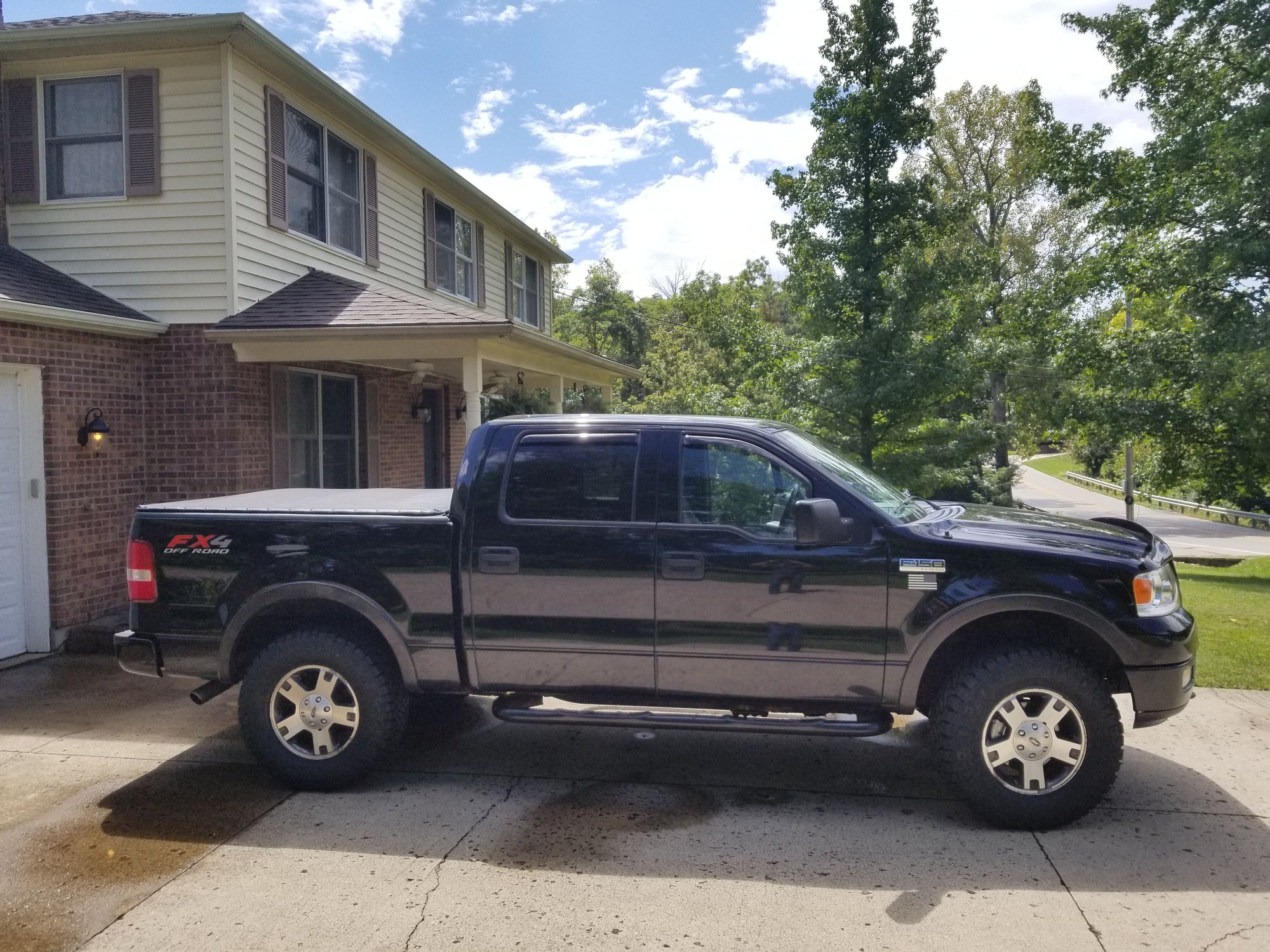

295/75R18
Just for future searches I'm going to add my pics of installed today nitto ridge grapplers 295/70R18 on stock rims. 2004 FX4 2.5 HBS level
Before
After
