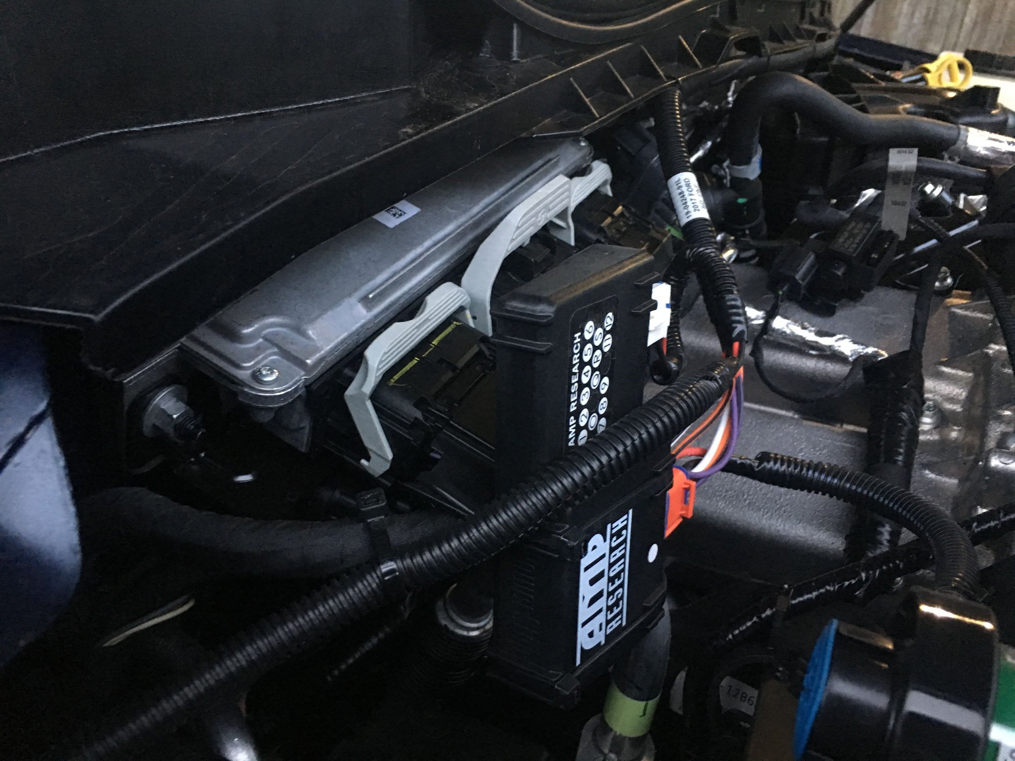

Skip the AMP LED lights. Go with a waterproof LED strip. The AMP ones are Worthless And have a purple hue. The Amp control box, I mounted on passenger side above the truck ECM (very large wiring harness). The AMP wiring harness is almost exactly the length you need with very little wiggle room. I did it alone in about 1.5-2 hours.

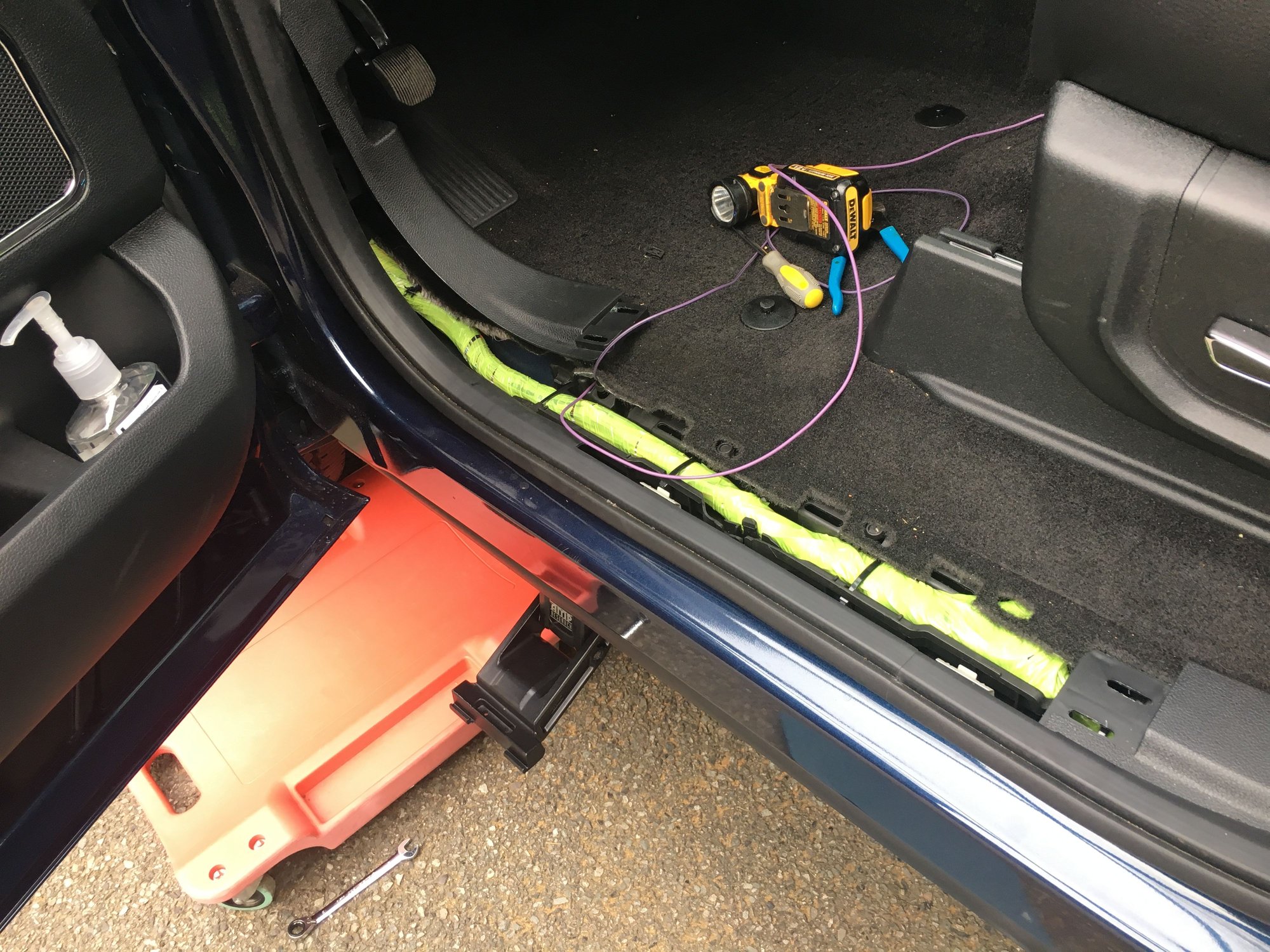

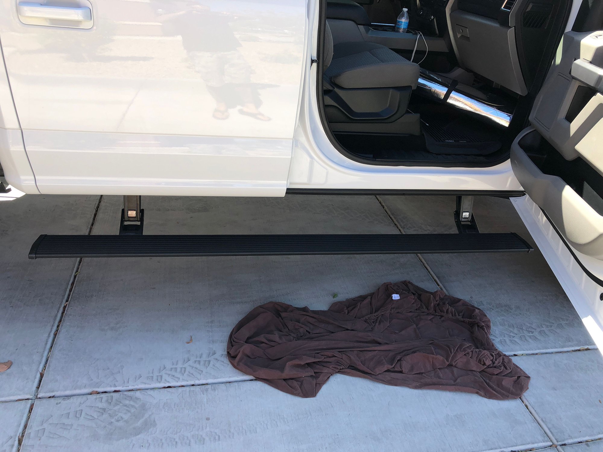

Here are mine that I finished not too long ago. Agreed with posts here that amp LEDs are crap and add the led weatherproof lights mentioned above. Took about 3 hours. And the override switch is at time of install os easier.

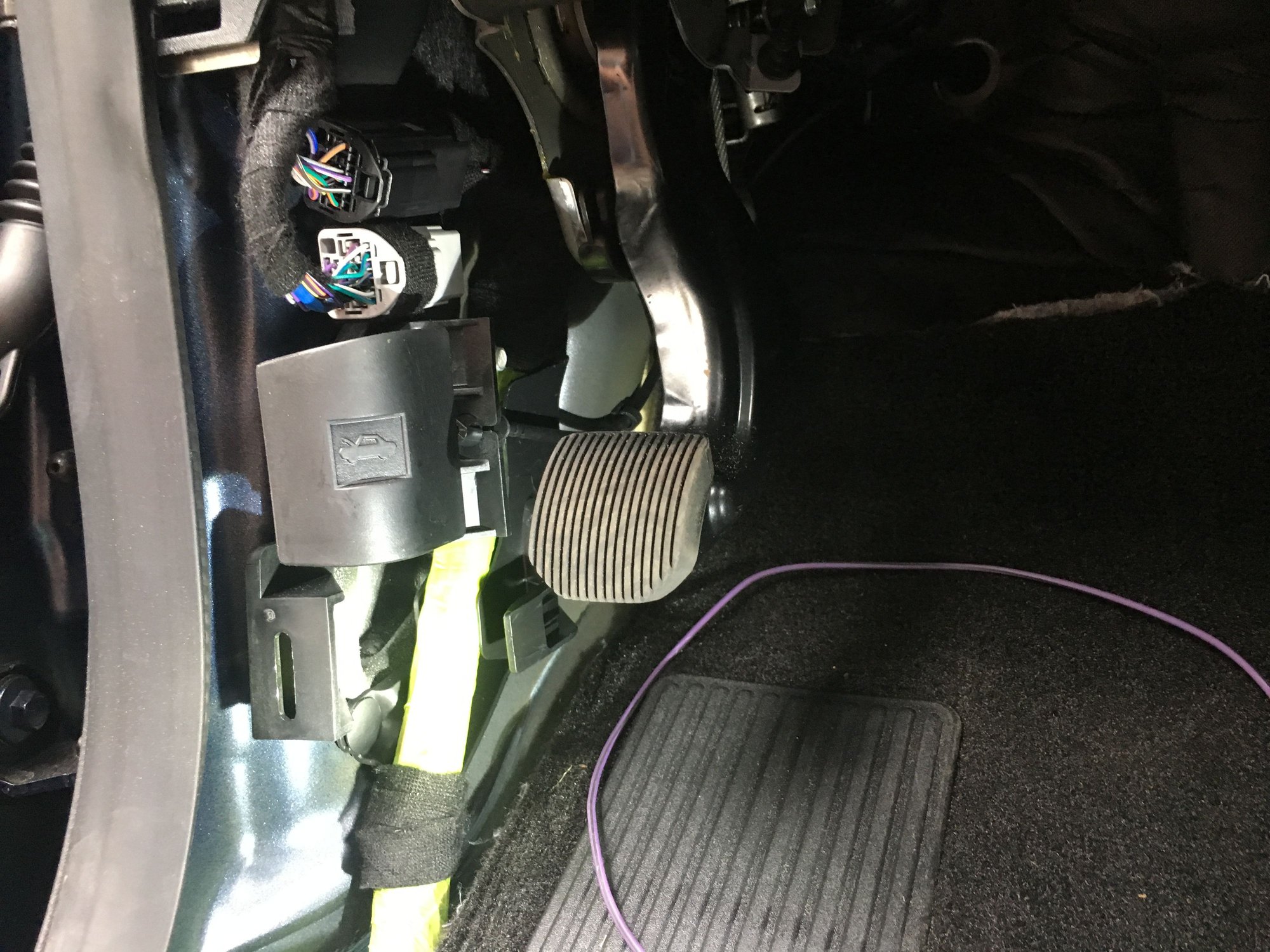

Fish tape to make it easy to get wires down passenger side and i zip tied my control module in a good spot i think. No need for silicone on grommet just drill a very tiny hole and its tight. It’s nice the thought of a path way for wires from the grommet.
