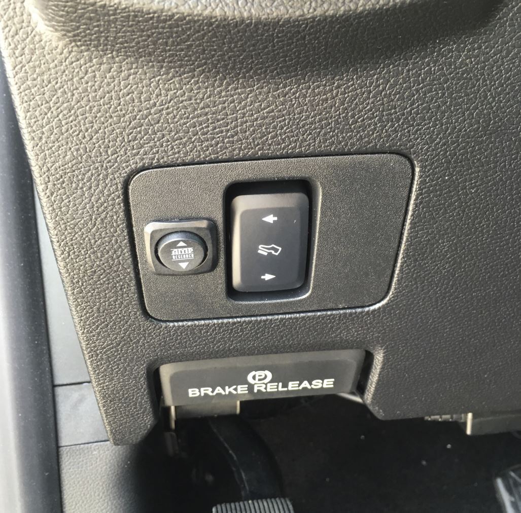

Two things I forgot to mention:
- if you get the override switch, the newer models use the less expensive ($35?) one
- make sure you put the switch in a good spot
After a long day of working on the truck doing other things too, I drilled a hole where I thought it would perfect.
Let's just say you won't be getting a replacement lower dash panel anytime soon - they cost $60 and mine took 3+ weeks even after the dealer changed it to an 'emergency order'
Was no emergency, they just got tired of me asking where it was. They are a giant PITA to replace too - need to remove the metal surround below the steering column.
A forstner bit makes a much cleaner hole than the spade bit I used the first time.
Also marked up the diagram so it would be less confusing for me after what I knew would be a long day with sweat covered glasses.
I like to leave the steps down to reduce door dings in crowded parking lots.
NOT here - panel won't close
Much better spot
Wiring cheat sheet

Jake
Just to confirm the override switch next to the adjustable pedal switch works like a charm?
Thanks man!

Originally Posted by rrider
Jake
Thanks man!
Yes sir !
I had the (oops) opportunity to put it anywhere I wanted once the new panel came in and in retrospect I should have put it there to being with.
There is a honeycomb pattern on the back of the panel - can take (EDIT: more) pics of the old one if you like.
