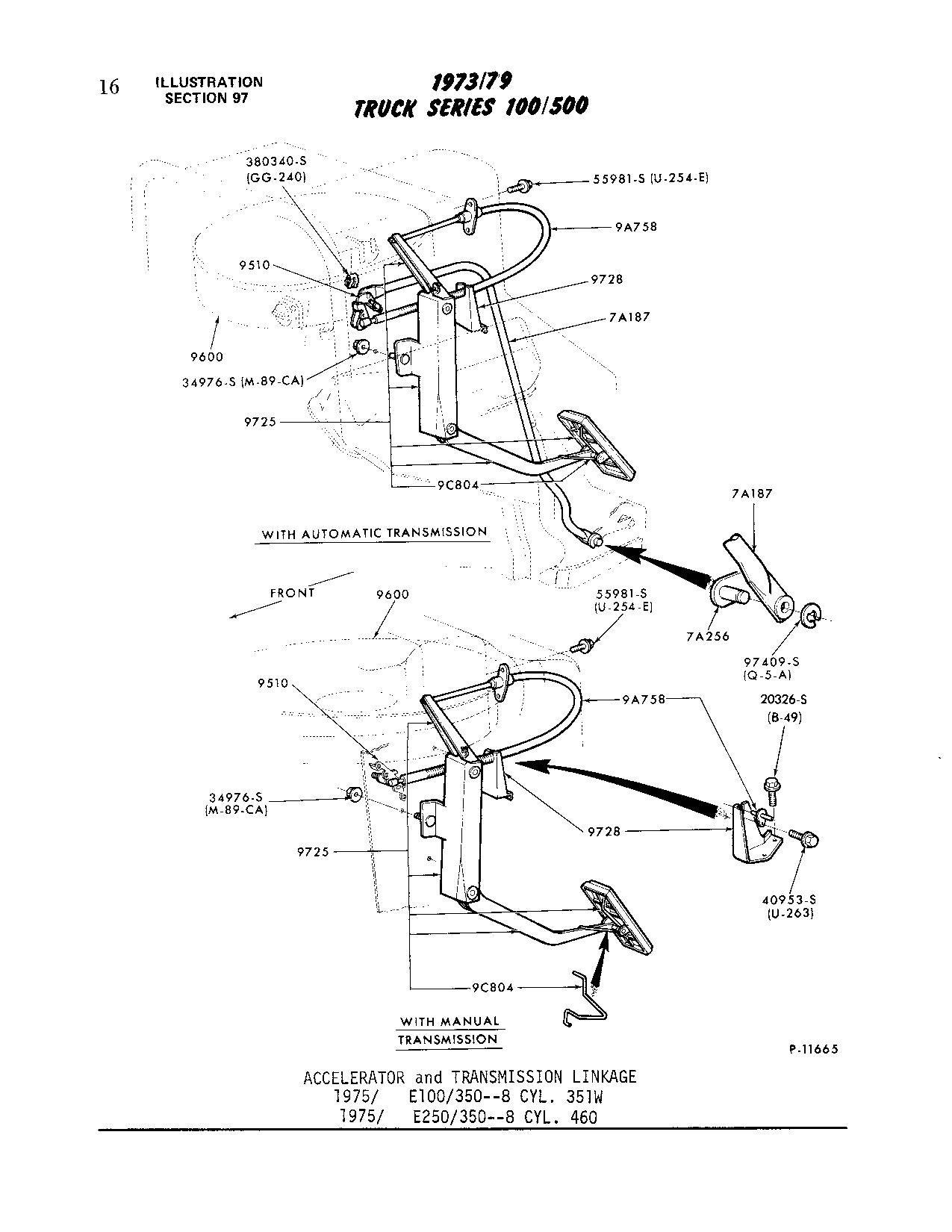

Can anyone tell me where the transmission kick down connects to on the engine?

Originally Posted by Foundonroaddrivin
1978 E350 460/C6: Can anyone tell me where the transmission kickdown rod connects to on the engine?
Kickdown rod is 7A187 in pic. 7A256 is the manual control selector lever on the side of the trans. 9A758 is the accelerator cable.
