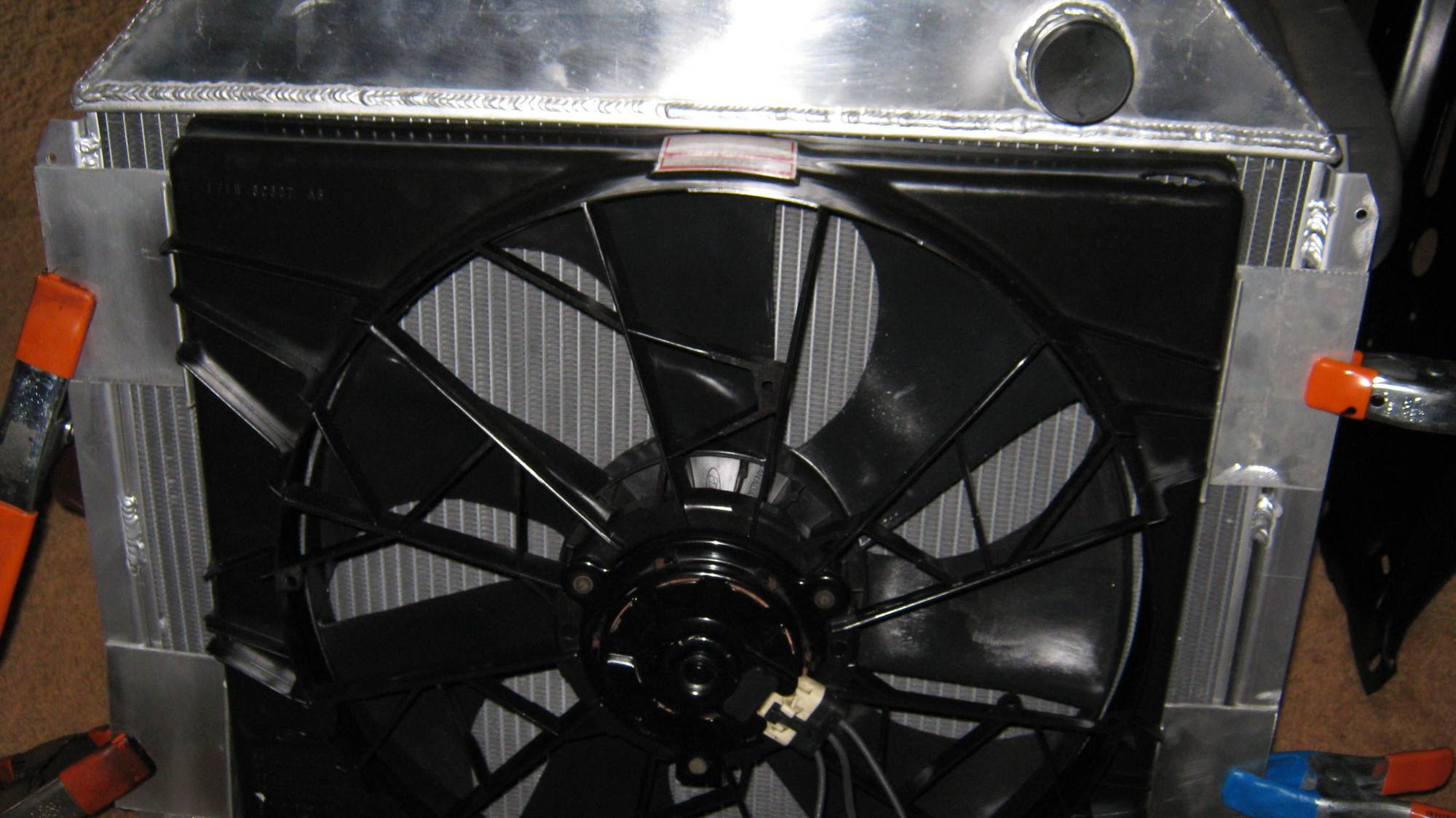

MarkV111 and champion///// pig tail was a perfect fit motorcraft

mounting Mark8 on champion
Cali Ranger asked ? about fab set up,inner holes on champion work for fan,,,outer holes line up perfect for rad core
