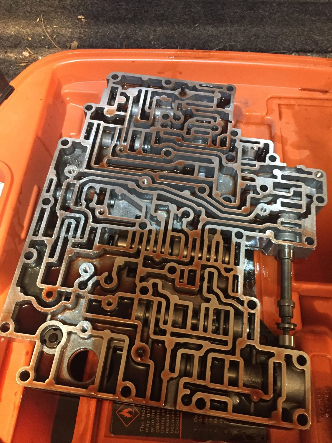

Well, I have taken out the valve body, found the broken snap ring, replaced it, checked for loose pieces and test drove. No change. What did I miss? The servos? The ones beneath the valve body seemed fine. Not sure if the overdrive servo is in the same place?

Did you make sure all of the pieces are out of the valvebody? Does the valve move freely? Did the od servo come out of the case? Are all of the pieces of the snap ring accounted for?

I’m afraid I was not careful enough finding all the pieces. That’s why I put up the picture. I think I was focusing on the wrong area vs. the entire valve body. I’m going to remove it again tomorrow.

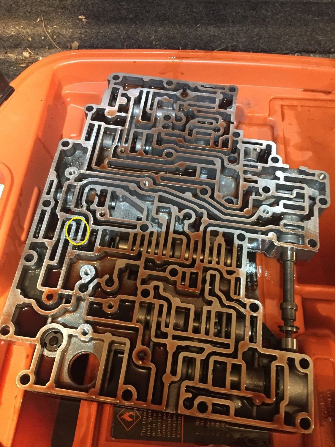

Look here for a piece of snap ring sticking the valve.

Yes, look for ALL of the c-clip. There will be a piece of it in the valve body.

Thanks for this! My servo did come all the way out. I was wondering about this as it was mentioned above. So I should have that tool available and should remove the servo again? Is there a way to tell if the band is engaged? Or if I find a piece of scrap in the valve body, that confirms the fault?

It could be both if the servo came out. Try to find a hole in the case that allows a screwdriver to push on the band when you reinstall the servo.

There is a opening in the case that you can see the band, when the servo is out you will have to use a pick or something to catch the band through the servo bore and hold it tight against the drum. Then through the opening in the case you use a screwdriver to hold the band in place so you can let go of it through the servo bore and install the servo piston. You can make sure you have engaged the band by pushing up on the servo, you should be able to see the band move.
