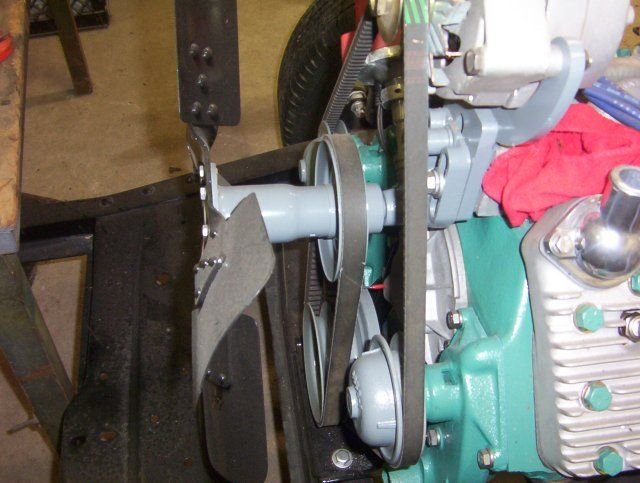

Got the motor in and running. After a couple minutes it stopped dead and it turns out the fan shaft seized ip in the bracket. I dug grandpas out of the saved parts pile and it was smooth so it is back in service. Grandpas 52 fan had a bit of an X to it versus the + shape of my replacement. I put the + on grandpas shaft and about a tsp of oil leaked out. Book says fan requires no lubricant. The seized one was clearly dry. I added some engine oil to replade the lost and it appeared similar. Its on snd tunningvway quieter than before. 3 questions: whats up with the oil/dry brackets and whats up with the fan shapes? Thanks guys

Dry shaft

2 differnt fan shapes

All my OEM Flathead fans require lubricant. I use the same oil I used in the crank case - SAE30. Note that this was Ford's original recommendation, but later changed it to gear oil.
You can read all about it here: Ford Oil Filled Fan Assy
As for the fan styles, Ford used many blade setups between their passenger vehicles, Ford trucks, and Mercury's with arrangements of 3,4 or 6 blades of many styles further compounded by aftermarket parts.

I guess i was lucky to have a spare. The shop manual us way different than the Van Pelt article. Thanks a bunch.

A '53 should have come with a sealed ball-bearing fan assembly, as shown below. Someone must have swapped it for an earlier style. Is your engine an EAB (casting numbers on the heads)? The whole engine may not be original.

I bought a NOS fan from DC a few months back for a 52, it was an X. My guess is that was a design improvement to help in taking the radiator out without having to dismantle the fan assembly? Any work in that general area is a real nightmare.
