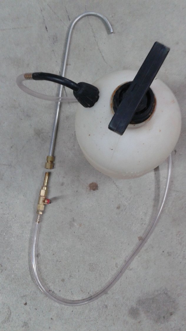

I have done something similar using a one gallon jar with my vacuum pump attached to it. I have even pulled the oil from a differential through the check plug/fill hole using it. I plan on using it for extraction on the 6R80. I have also fabbed up a garden sprayer pump to fill the pan on my '05 Explorer 5R55 trans. I made a hooked adapter to use for filling the 6R80 and other things, as well. I don't have a pic of my vacuum jar, right now, but here is the fill pump.
