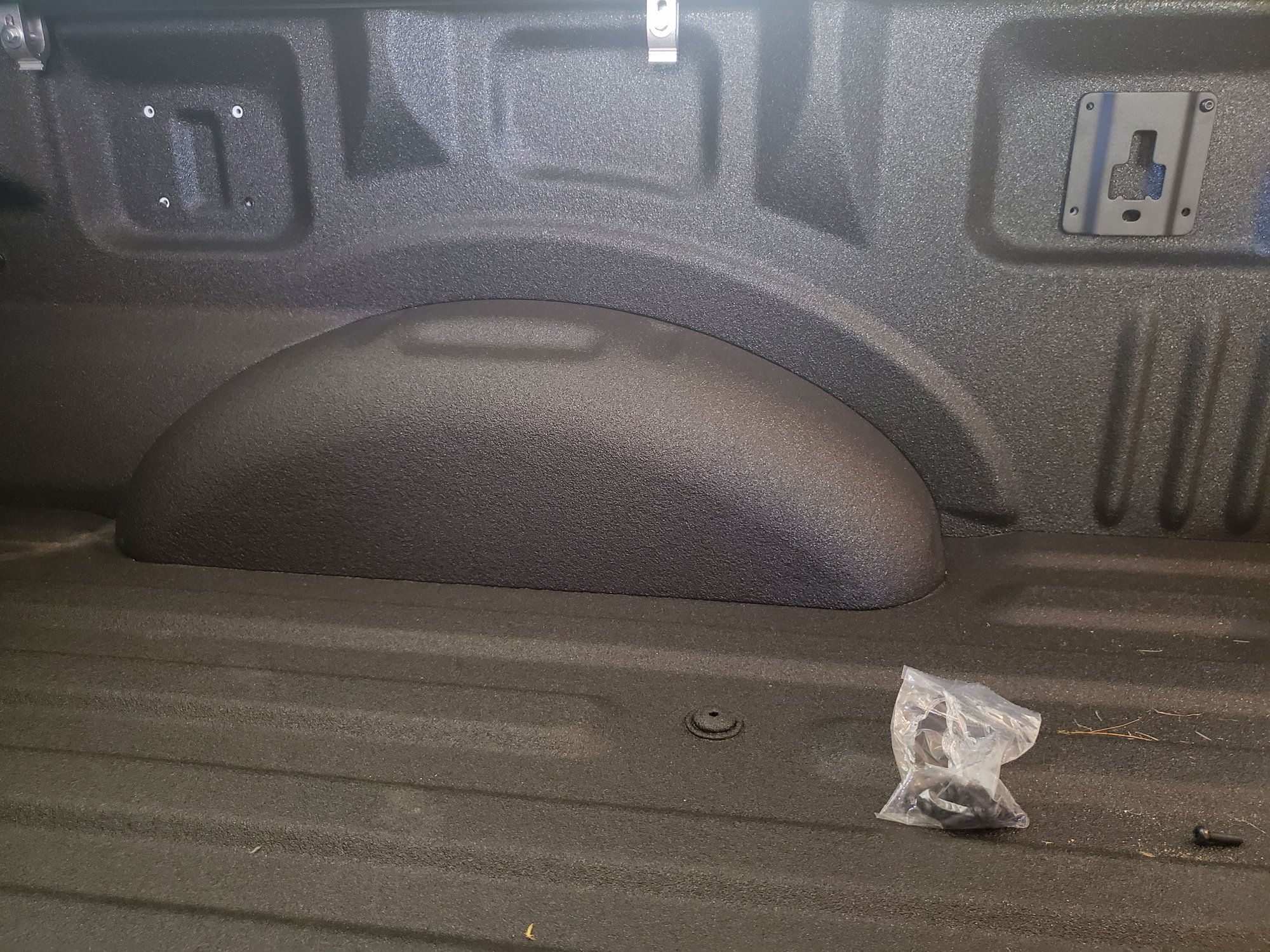

Got the boxlink brackets yesterday and got them put in this morning.

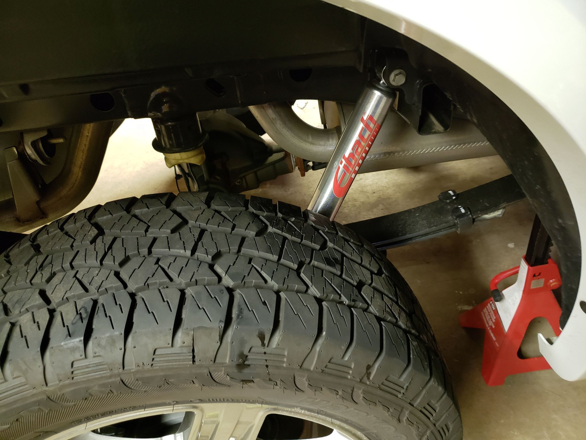

I recieved the rear shocks yesterday from stage3 for my Eibach pro truck lift, so my daughter and I went ahead and put them in. I could not have done the job without her. She put the bolt in for me while I held the shock compressed. Still waiting on the rest of the kit. I have autosprings rear 3" blocks to go in, but not knowing how soon the fronts will be here, I didn't put them in yet.

Just a friendly head ups, your rear Eibach shocks are designed to be installed boot down. You'll notice the drain holes in the black aluminum mount.

Ah man! Thanks for the heads up. I'll have to get on swapping those over. Feel a little dumb. Oh well. Live and learn.

Oh, don't feel dumb at all, I think Eibach could do a much better job with their instructions. Just to confirm, here's a photo from the Eibach SEMA booth:

Fixed it

I looked for something that will tell me which side was up, but didn't see anything, so I matched the factory shock. I see the drain holes now, and it seems pretty obvious. Thanks for the heads up!

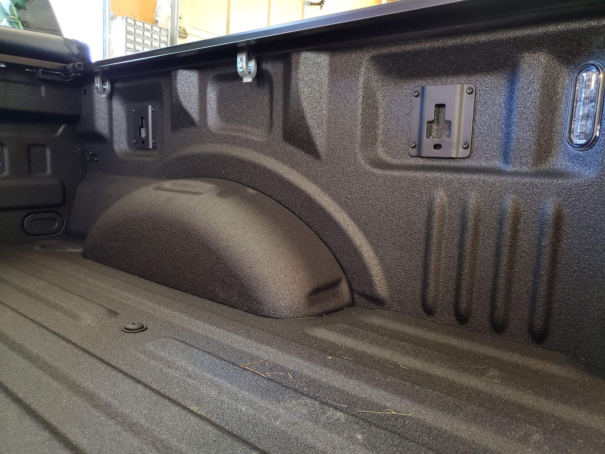

Looks great...love the Rhino lining. It looks 100% better than the factory spray junk (which I have).

Rides nice, no clunks. Noticeably higher, with a little better body roll control and less nose dive. I'll get pictures and measurements this afternoon.
I had hoped for line-x, but I only have experience with it. We'll see how well the rhino lining holds up. Seems a little softer, yet more abrasive than the line-x I had in my '10. Granted I got that used, so maybe this will wear in nicely. Definitely looks better than the white bed, Haha.
