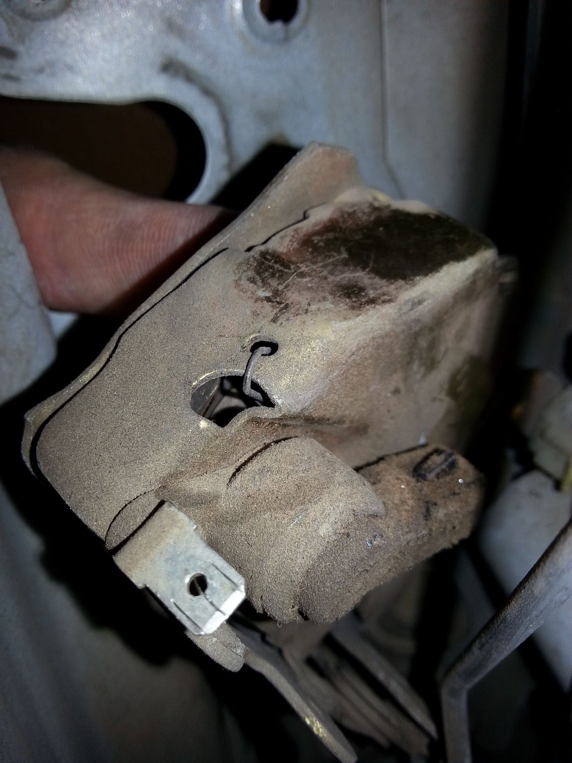

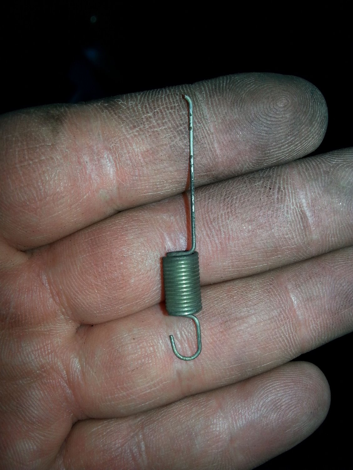

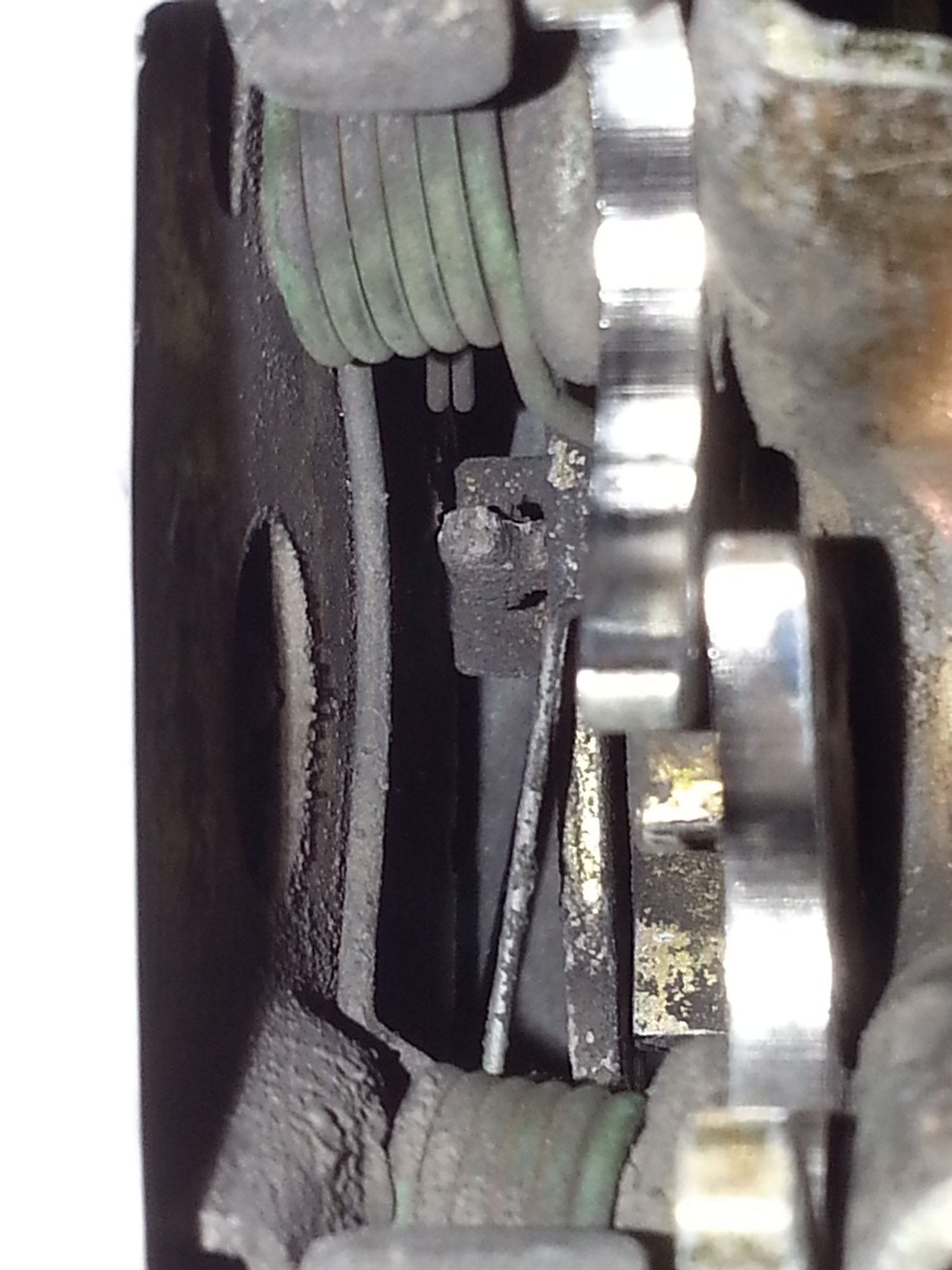

What had had happened was, the door unlock assist spring broke (photos) and was dangling within the door latch mechanism. With the spring broken it was impossible to unlock the door either with the key, with the electronic unlock or even the pull ****, the ONLY way to open the door was with the inside door handle, and with the spring in the mechanism this made it tough to open. Got the door apart and the mechanism loose within the door so I could extract the spring. Got the mechanism back in place but without the spring was still unable to unlock but was able to bend the broken end and get it back where FORD intended it, though not in factory configuration. Now along with the failure of the assist spring the outside door handle springs also failed so not it flaps and rattles, well got a new one on the way, should be here Friday, and by that time I'll have a replacement spring so one more time inside the door to complete this repair.
Broken spring end hanging in the door latch mechanism.
Stock location of the unlock assist spring. I believe it runs along the inside of the latch mechanism down to an attachment point on the unlock arm. New spring will run along the outside.
Door unlock assist spring after removed from the latch.
