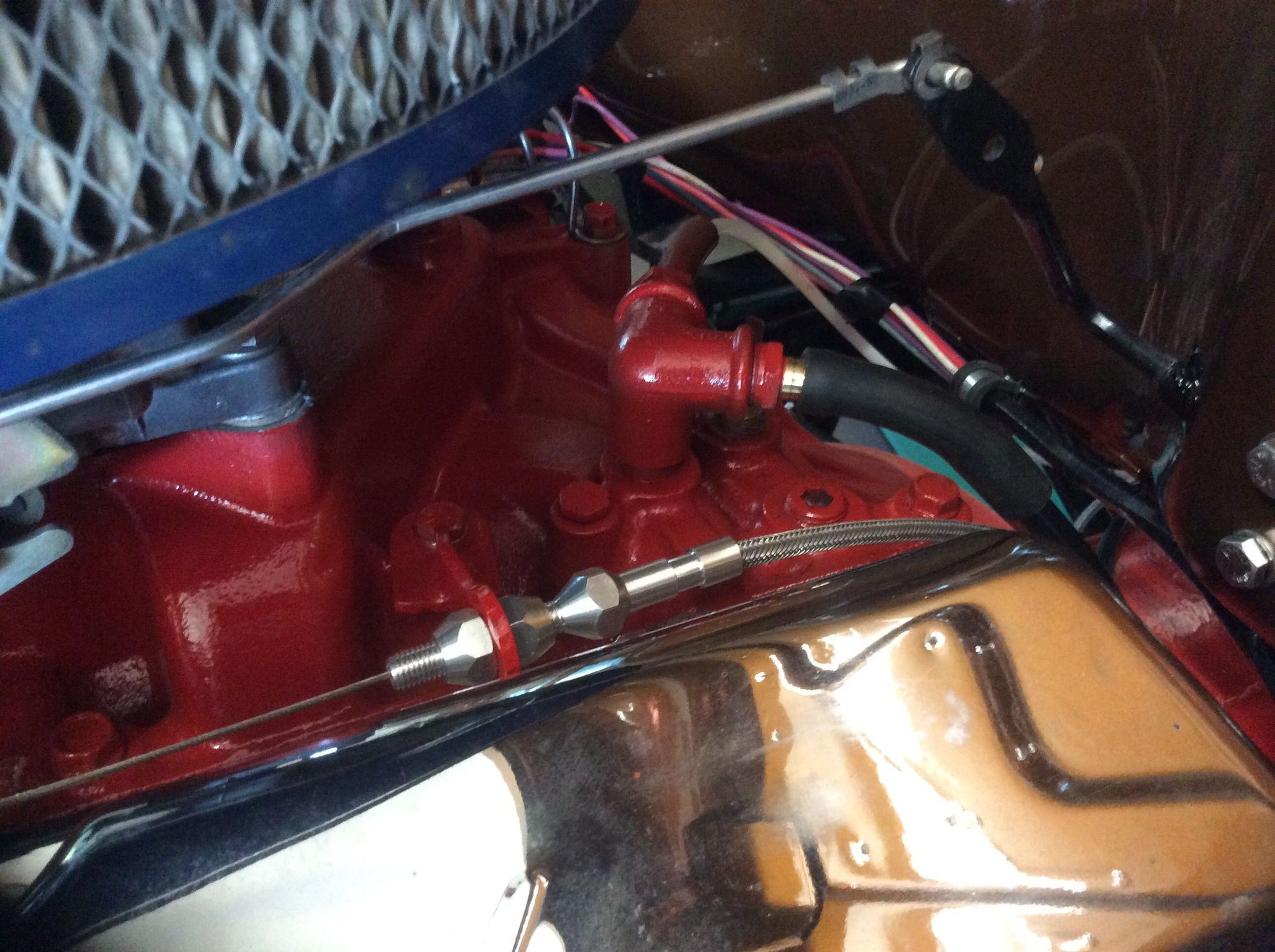

Vacum questions
can i use this outlet for vacum to transmission and power break booster ?
Old Jun 27, 2018 | 01:15 PM
Pladsmand's Avatar
Pladsmand
Joined: Nov 2017
Posts: 165
It`s A Ford 302

Where do the existing hoses lead to?

It’s me WHO has screwed tee piece and led the little hose to transmission and the big to power breake boost

Yes. That is your manifold vacuum port on the intake manifold. It is there for exactly that purpose. It's where the factory plumbed their vacuum from for the same functions.

Transmission uses full vacuum ?

you don`t mean that it`s the right place to take the vacum for the transmission ??

I think you will need to add a vacuum check valve if there isn't one already on your booster.

Vacuum sources can be either ascending or descending , meaning that as rpm rises vacuum rises ( carburator ) or drops off ( manifold ) . I don't know what your trans is designed for . But 52 merc has said this is the proper placement so you should be fine .

Ford transmissions used full manifold vacuum to a modulator at the transmission. The Factory tee off the intake would have looked something like this. The large port for the brake booster, small port for the transmission.
