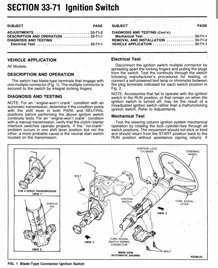

Originally Posted by southern-old-bold
I've scrolled looking for a post on malfunction in the column key switch, mine has stopped travelling to the start position in my '83 F100...<
In your F-100: If your ignition switch is the same as on an IDI truck steering column then YES there is an "adjustment" and when installing a replacement switch you need to follow the proper adjustment procedures. I will post the 'Ignition Switch" section from the 87-91 factory service manual so you can see what it contains, troubleshooting etc., including the adjustment procedure. It should be the same for all of the IDIs. That will take a little while since I have to photo-edit the screen shots before I can post them.

IGNITION SWITCH Section 33-71 Factory Service Manual 87-91.
There are two pages in this section, 33-71-1 and 33-71-2. As previously stated, as far as I am aware, this should be the same for ignition switches in all years of the Ford 6.9L/7.3L IDIs:
