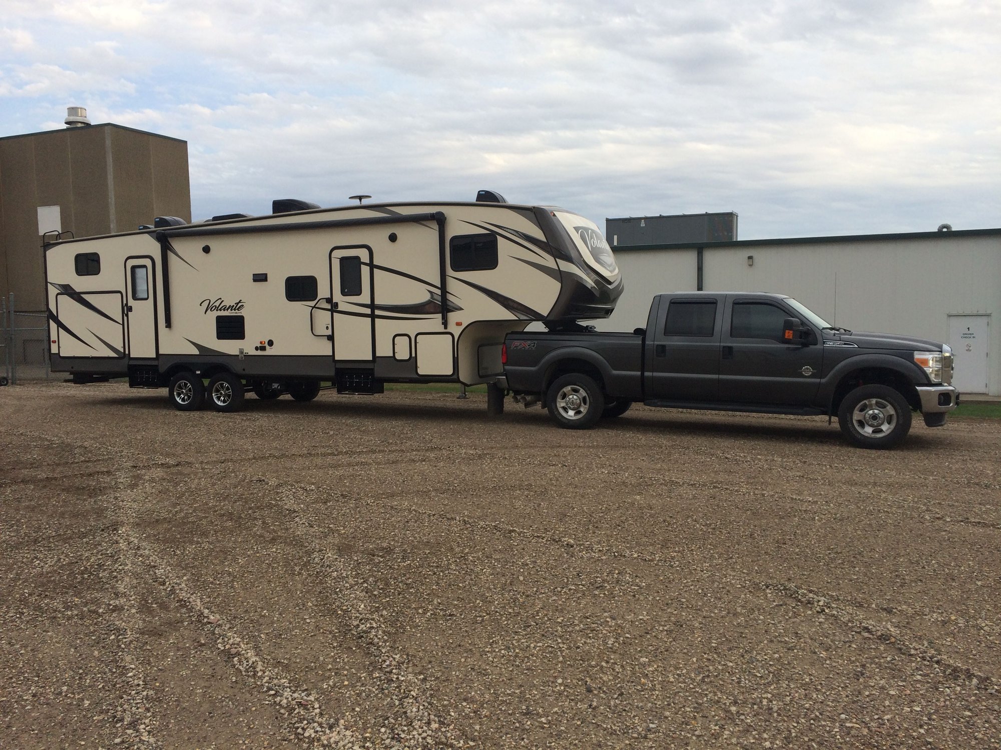

I have a similar sized 5ver. I certainly don’t consider it a heavy one either.
I have a F350 as you describe and I use the steel gooseneck AUH. I have an 5” offset gooseneck ball with the AUH kingpin adapter pointing to the rear of the trailer. Works and tows great. I can make full 90 degree turns with this setup.
I have the standard pin box. Don’t need anything else.
Here is a photo of my rig.
I’ll be hooking up tomorrow and I’ll post pictures of my connections then.
I too was a non-believer, but I’m now a full convert!

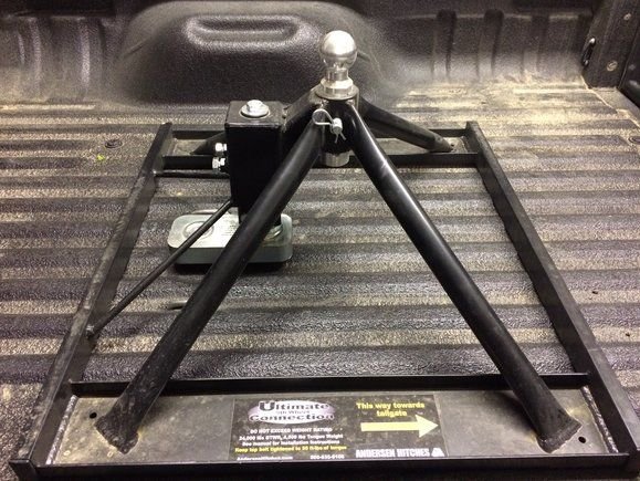

Sorry it was a late night. Had to setup on the dark and forgot the picture.
Here is just my AUH with my drawtite 5” offset goose ball.
Here is how the kingpin connection is oriented.
With it setup this way I have better turning room and have some breathing room between the tailgate and camper when hitching up.

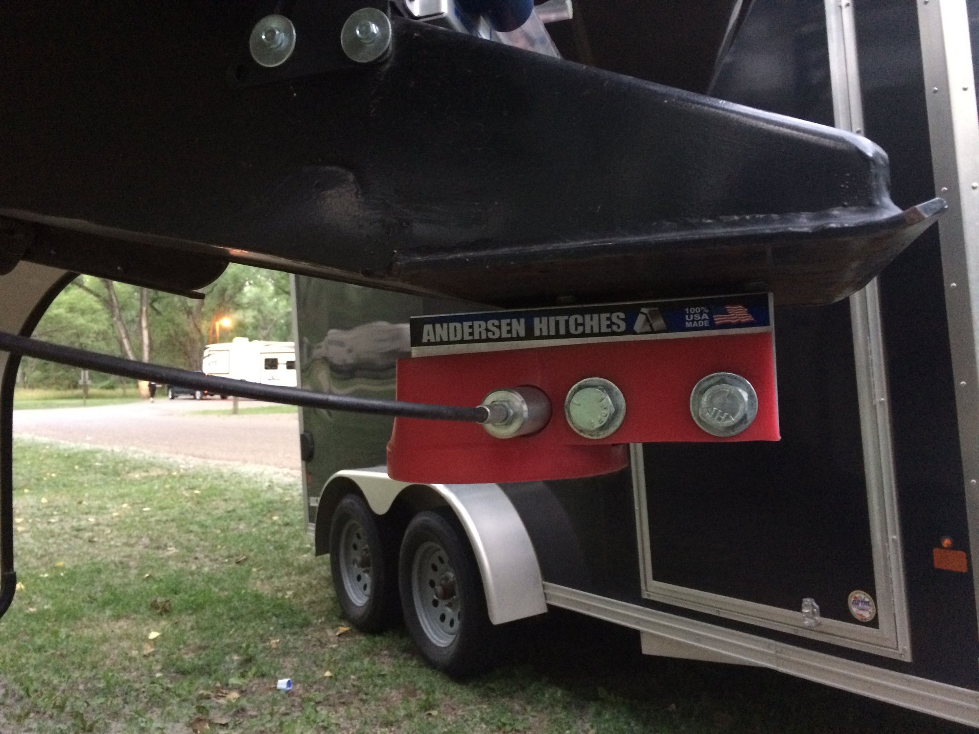

Here’s with it all hooked up.
