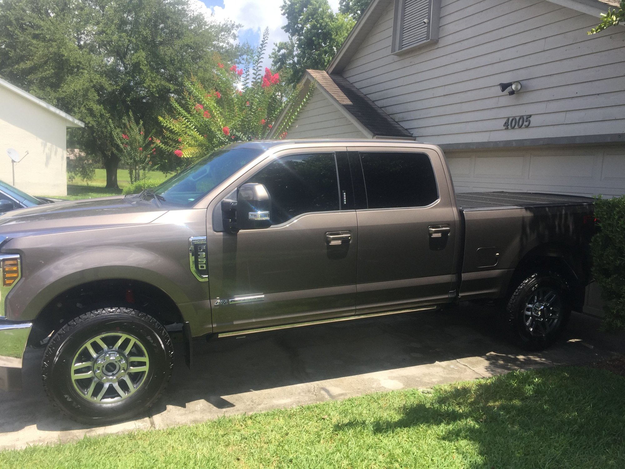

very helpful. I am the guy with the pics earlier in this thread who lost his F350 trying to hide his car from a hailstorm under a giant Oak only to lose it to lightning. If I had known then about PDR and your business I may ( maybe LOL) reacted differently as the storm approached. btw when not traveling, where is your home base area?
below is my new F350( Stone Grey)— exactly the same as the last truck. Except this go around I had an additional $3k PCO which helped. But a long 12 weeks. btw Nicknamed “Phoenix”
