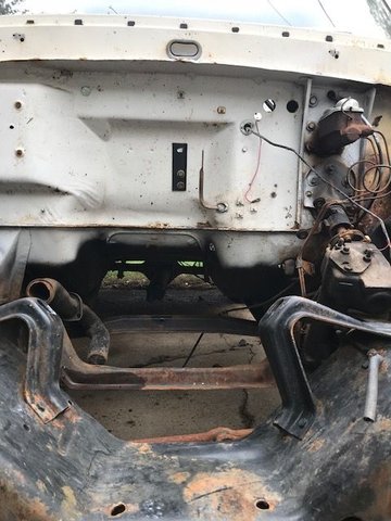

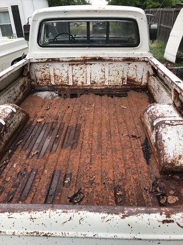

Here are a few picture of my project truck with a no go motor. I have now bought a new to me 390 engine from a paint and body shop that bought a 75 4x4 to get the panels. I got the motor for $150. and they pulled it and set it in the bed of my truck so I could get it home. I think I got a good deal. I have taken it down to the block and tomorrow I will mic the cylinders and see if it has been bored out. I did not see any signs so far that the motor has been apart.
some good scrap metal here on the drivers side.
close up for those of us not so good eye site.

Thanks for the help. I will use the D2 heads, I did look it up in one of my truck books and 1976 was the last year of the 360 I think the mechanic at the body shop was not up to date on his trucks either. From the note above these heads were made nov.19th 1975, That is great info since now I know when this engine was really made. Thanks for that info Numbers Dummy, The rusted up part of the engine. I bought this truck out of a guys drive way on the side of the hwy and saw it as I went by at 75 miles and hour in my 2006 ford truck. My wife was a little nervous as I slammed on the breaks and started backing back down the side of the hwy to get back to the truck. I asked a young girl who came out about the truck and her dad was rebuilding it as he was a machines. She found him lying in the drive way and the ambulance people told her he had a stroke. He is paralyzed now and she did not know nothing about mechanic work as so no one covered up the engine. I payed to much ($900.)but she need the money to help with bills. I now have a 1969 Ford F100 with all the original badging on the fenders and a 3 speed tranny. The bed is see thru but I do have a tig welder and will fix that with a new bed insert.
