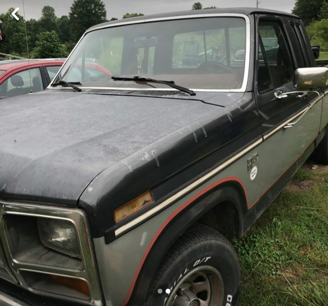

Side trim or no side trim?
Looking for opinions.
The side trim (just below the dent) on my ‘85 F150 Explorer has pealed up at the nose and door.
I can either try reattach, buy new, or remove.
I’m leaning toward removal, as the trucks look cleaner without it, to me.

If you pull that trim off, be careful with it, you might be able to sell it. They do not make that style anymore. It looks like common trim till you look at how the center is silver, the outside is black. Most aftermarket trim is silver on the edges and black in the middle.
A trick on the 80's and 90's mustangs was to pull the trim off, peel the metal insert off the back, and then use normal trim adhesive to glue it back on the body. If you leave the metal insert on the back you can't get it to lay flat on the body.

Obsolete, no one has any of these 1985/86 only mouldings NOS and the door mouldings with the TYPE 9 mirrors (as pictured) are unique.

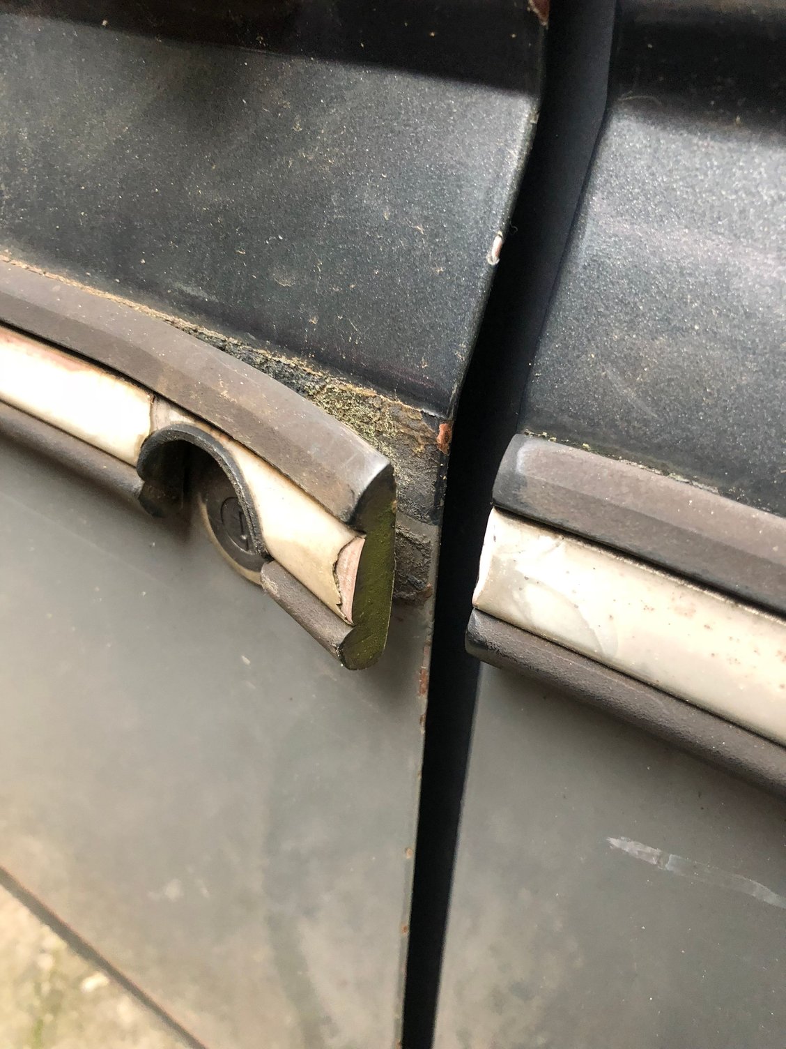

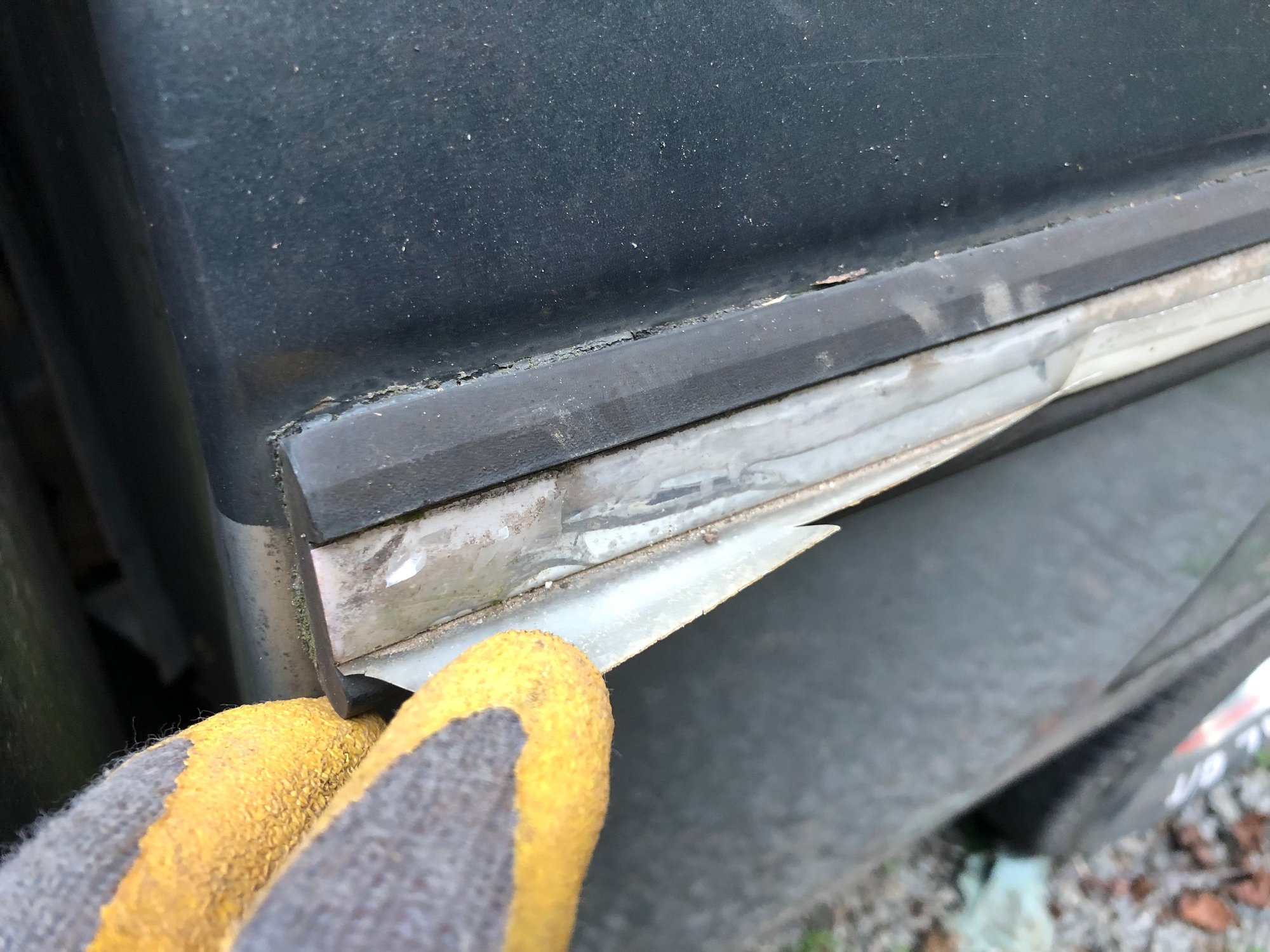

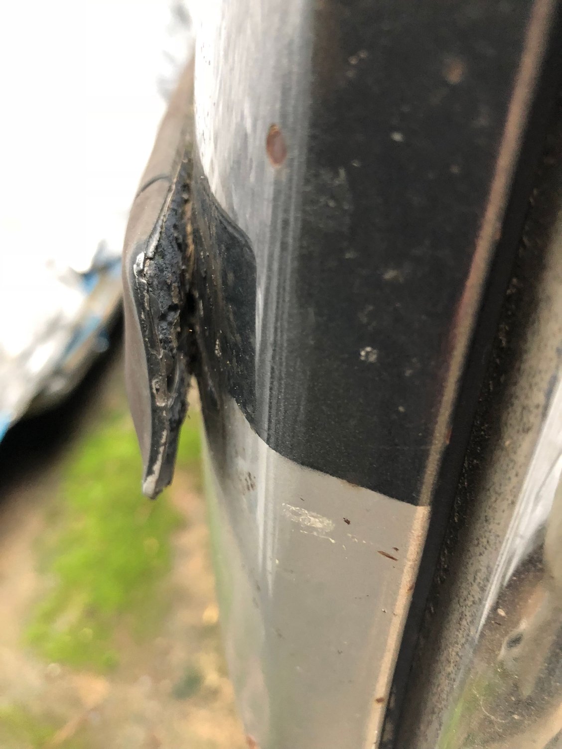

Here’s my reason for asking.

Yours is in pretty lousy condition. I don't know if it can be restored or not, but I am like you, it doesn't look good and I would rather do something quick and easy to make the truck look better. I agree with the no trim at all idea or just take that off and get some generic aftermarket trim at the store if you need to cover something up on the body.
