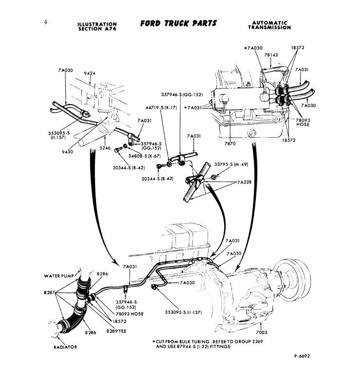

The original trans cooler lines are not just two simple lines that run from the transmission to the radiator. They are routed to a few different places and a number of hose clamps and connections. I believe the port with the valve is used to inject air into the lines and observe for leaks at a presure that is higher than the normal operating pressures. Just a guess, but I'll see what else I can find.
It was more like this picture where it branched off of the lower radiator hose and went to a cooler on the side of the transmission. I'll post another link to some actual pictures of a 1966 system.

Might be trans pressure. Sure, that makes sense. Looking in a 1961 manual to see if I can find anything. They were not used after 1964 on the trucks as far as I know. My 1966 doesn't have the valve.
Here's an example 1966 system of the cooling lines. They are a hoot, but I hope to find some so I can take my truck back more to original.
https://www.ford-trucks.com/g/album/8395561
