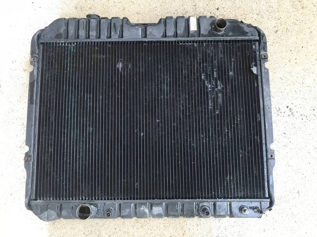

I got my radiator out tonight. Here it is:
Attachment 285182
The problem is the little port next to the drain valve. This is a coolant line from the bypass line coming out of the manifold. Evidently this is designed to provide some coolant flow through the radiator before the thermostat opens up. To what purpose, I am not sure. Someone suggested it was to pre-heat the transmission fluid before the engine warms up. I wonder if it is in fact to provide cooling for the transmission fluid before the engine heats up.
Anyway, I'm going to try a radiator shop here in town and see if they can rebuild the radiator.
Steve

Well I did some searching and the only one I could come up with was the one you linked to at Advance.There may be one more but I am not sure it is the correct one.
Advance is calling it a Craquest brand.. Rock Auto lists it as ADPI (Automotive Parts Distribution International)
Advance specs say it is a 3 row core... ADPI lists it as a 4 row core but when you click on the part number it comes back as a 3 row core. 8011291
I didnt see where you posted what engine you have but the only radiator that seems to match would be for a 460/7.5L engine...
The port you are calling a heater bypass is called sensor port on most of the radiator sites. That radiator comes with or without a sensor port. Some cay "comes with sensor". So in your case they are not using the a sensor in the pore, but are using the port.
Where is the radiator made or come from? If you look at the ADPI , carquest, ect, they all look about the same as this one
Not positive this is the one with the port..
Radiator,Number5UA8005UA

It's a 460 engine. Motorhome. I did not find any with the sensor port. Did you find one?
I ordered the Advance Auto one. I took my old one into a shop today and they recommended just buying a new one since they are only about $200. I'm concerned that they say 3 row but they say they replace OEM 4-row. I asked online chat from Advance and they said the unit was made of aluminum, but I am not sure.
If I can't get one with a port, I will just put a tee where the drain valve goes and then put the drain valve in the tee and also the connection to the bypass hose.
Steve
