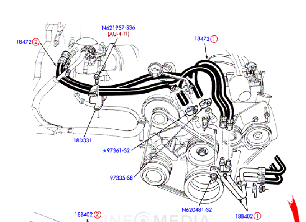

Originally Posted by colinmcc
There are two similar looking hoses, one splits the hot water from the pump to the heater matrix and one combines the return water back to the block. I am not clear as to which of the numbers you quote is which. I can find F29Z 18472-AA on the net at $155.00 but F29Z 18472-A is only $9.95, so I'm guessing that F29Z 18472-AA is one of the long 'T' hoses, and that F29Z 18472-A is a clamp or end fitting(?). Can you please clarify which the two large 't' hoses are and their respective part numbers. I really would appreciate your help. Thank you!
F29Z 18472-A supersedes to the F29Z 18472-AA, so they are basically the same hose.
The lettering I have on my line I replaced is “69H-18C-266-JA”...which doesn’t seem to correspond with yours. If you’re looking to the passenger side of the engine, the two hoses go into the firewall...I replaced the bottom one, which looks to correspond to the hose you’ve got in the picture on your post. I found what looked to be the right part on ebay, and lucked out because it in fact was. Hope this helps?
You are missing a letter, E69H-18C-266-JA, which is the engineering number, which goes to a E69Z 18472 T which fits an 86-88 3.0 w/ AUX heat.
