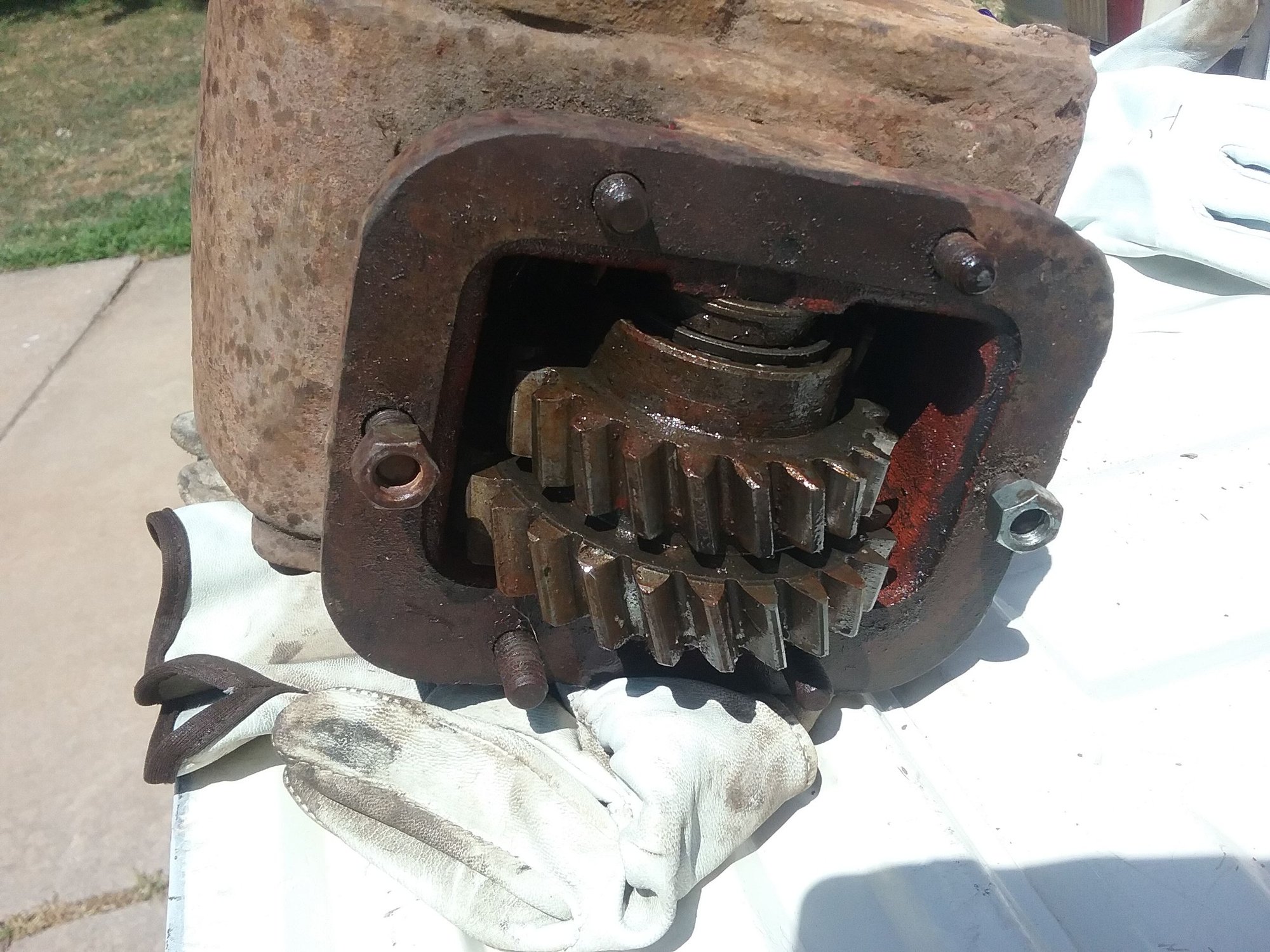

Hey all, I found a PTO at a garage sale that will bolt up to my 1994 e4od. Does anyone have experience with these? Is it just a undo the plate and bolt on or what else has to be done? Want to use it for a wrench if possible. Or if anyone has other uses or advice please tell. Thanks.

Oh ya, sorry it's on the transfer case. I found a Ford manual online, it was put on 350s with the snowplow package which mine has. So I assume it's for hydraulics. Still finding very little info on it. It's a Dana "Chelsea".

Those gears and the inside of the case look a bit crusty. I'd suggest you open it up and clean it out good before bolting it in.

The pics look worse than it is. There's really no rust or dirt in there. The oil is a little discolored. Wish someone that's used these could give me some info on them.
