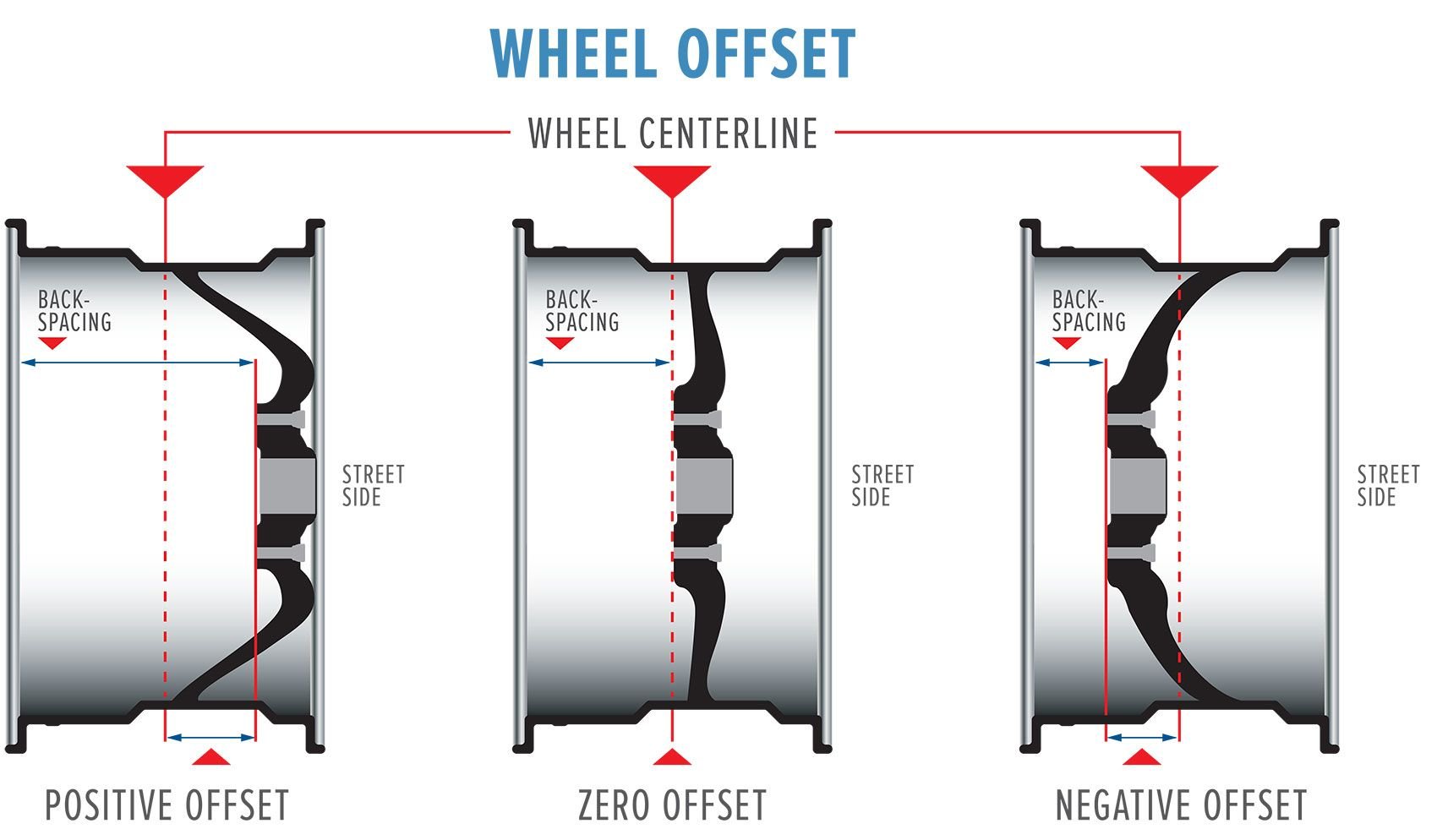

Does anyone know if 16" factory aluminum rims from a 2005 Ford Escape fit a 2005 Ford Ranger? They look the same and both have 5 lug nuts.

Offset and backspacing will be different because the Escape is Front Wheel Drive. FWD cars tend to have a positive offset and RWD cars tend to have zero to negative offsets

Practically all Ford cars and small trucks will have the same bolt pattern. The offset is different and will severely affect affect handling.

Negative offset, or "deep dish" or "reverse" wheels will cause a front wheel drive vehicle to have more torque steer, and they generally make most vehicles a little to a lot more unstable, and in the event of a flat or blowout in the front, they are a hazard.
Positive offset wheels as seen on OEM front wheel drive vehicles generally cause no issues on a rear wheel drive vehicle, and behave better with a blowout.

Also check to make sure the center hole of the escape rim is large enough to fit over the hub of the Ranger. I ran into this issue trying to put Ford Flex rims on my 2000 Ranger.
I ended up just going with American Racing AR899 16" to get the look I wanted and to open up my tire choices. Decent 15" tires that ride quiet are getting fewer and fewer these days.
