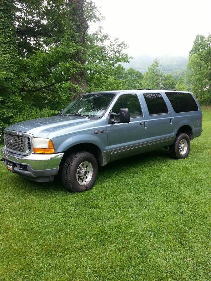

That price is very good if it is in good shape, as it looks in the photo you posted , as stated before check for RUST!!!

I am a very big fan of the V-10 engine in these giant wagons, they are capable of getting some pretty heavy work done, of course like any other platform they do even better with a few good mods. That picture looks good and so does the price. But as has been said, get under and look for rust, serious rust is a death sentence for older vehicles as good sound repairs can easily exceed the value of the vehicle. You mentioned that it's three hours from you in TN, hopefully it's even farther South so as to have had a salt free life.

I do like seeing those larger towing mirrors, if factory the EX may have the optional 4.30 gears which are absolute BEST option available for these big gas wagons, especially one that will be doing some towing work. But even if it has the more common 3.73 gears it should handle your middle weight TT just fine. My V-10 EX has an effective 4.39 ratio which performs pretty darned good as our dedicated tow rig for our 11,300lb TT which we pull all over the East. We were in TN just last week and the week before in both Nashville and Pigeon Forge, it handles those TN mountains just fine and saw towing mileage in the 8.5 to 9 MPG range.
