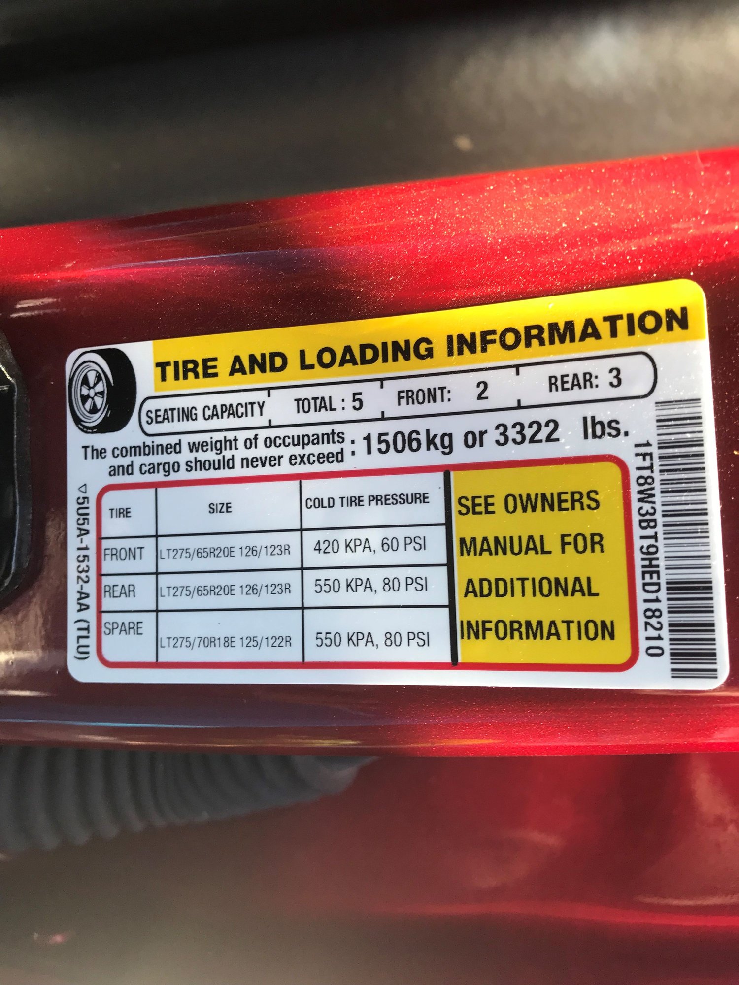

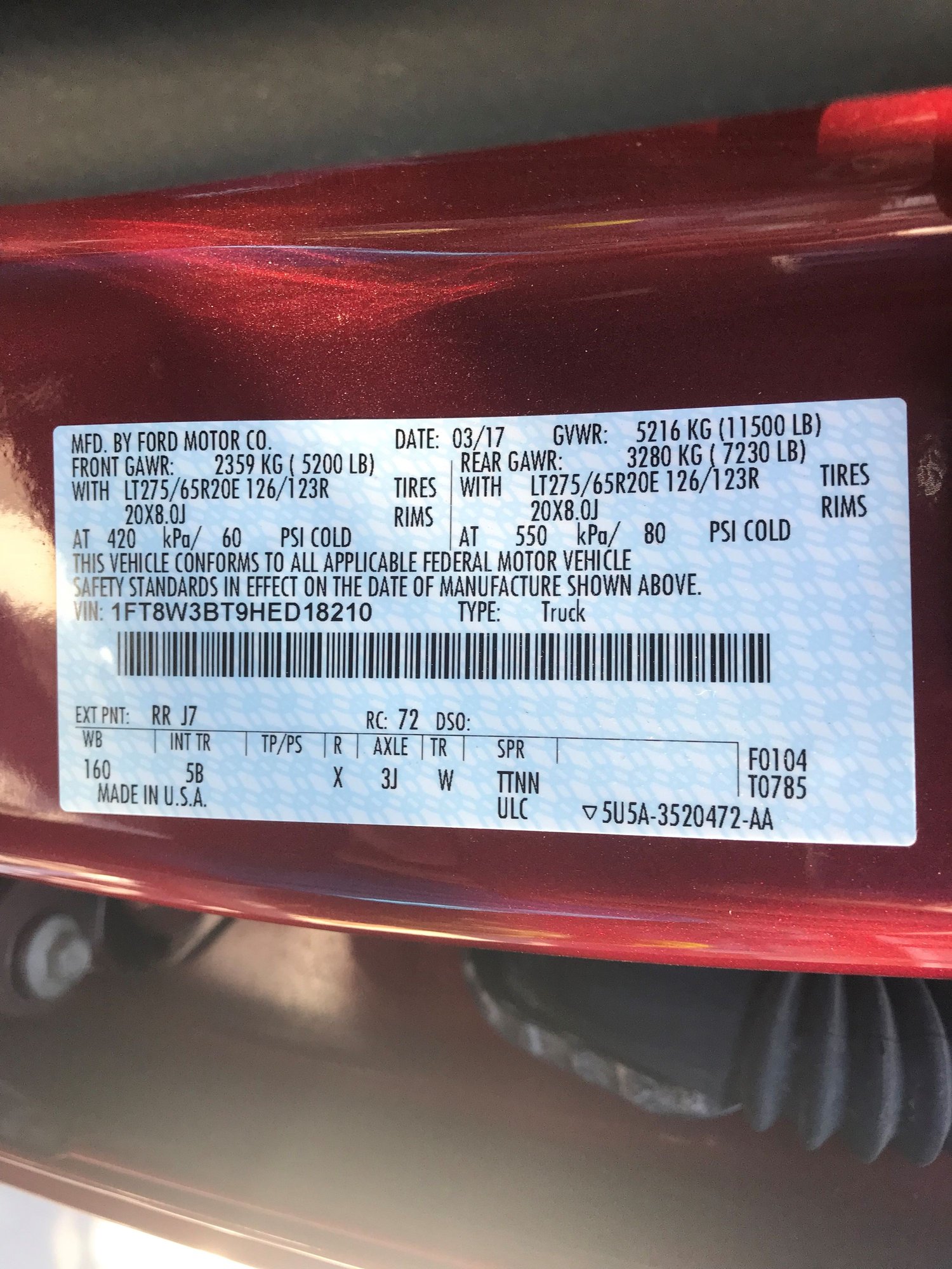

Here are the stickers from inside the door. I am not sure how to read them except that I am showing a 160" Wheel Base.

GAWR = Gross Axle Weight Rating - amount weight each axle is rated for
GVWR = Gross Vehicle Weight Rating - total amount weight the vehicle (includes actual weight of truck also) /passengers/payload/tongue weight of hitch, etc is rated to carry not the same as amount of weight vehicle is rated to tow

So you have 3322lbs of payload and a 11.5K GVWR. That means you have 20,600lbs of GooseNeck and 18,000lbs of 5th wheel assuming as the note states that is what your 5th wheel hitch is limited to. Anyone correct me if I'm misreading this.

Keep in mind that the 3322 payload needs to account for anything added to the truck including passengers, luggage, tools, hitch, fuel, etc. So if you factor in say 500+ for passengers, 300+ for fuel and 100+ for hitch. All told you can see well over 1000 pounds off so your fifth wheel pin weight (loaded, not dry) would need to be well less than 2400 lbs to be within spec. You can't have a pin weight that low with a loaded 15-16k fifth wheel. Would it tow that fifth wheel, yes. Will it be safe, very debatable, some people do it, I wouldn't. Will it be legal, no.

on a 16 k 5th wheel, your pin weight alone(3200 #) would almost max out your payload leaving you no room for all the other items mentioned above ( people, fuel, hitch, luggage, tools etc.) which is why it’s considered dually territory.

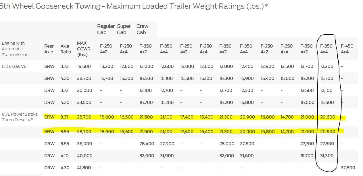

I got this off power stroke hub..................http://www.powerstrokehub.com/2017-super-duty.html
Old Jun 12, 2018 | 03:52 PM
  #41
icehckylvr's Avatar
icehckylvr
Joined: Feb 2017
Posts: 8
There is also this off the Ford website
