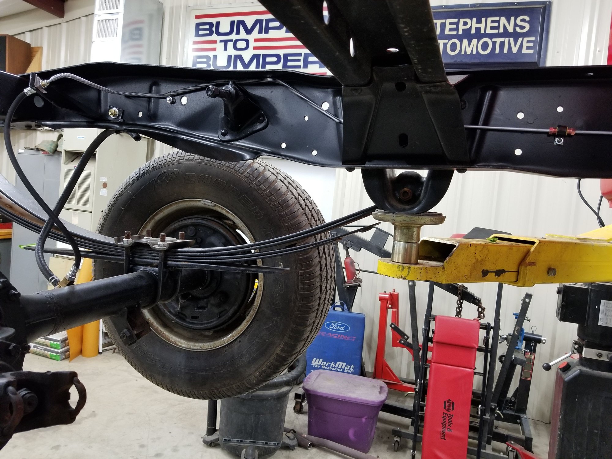

....last post posted before I got all the pictures included....

Nice clean professional looking job Ultraranger. The modifications on mine were a little easier since I used the cantilevered booster. So I was able to shorten the rod going through the cowl and not affect the booster rod. I did have to press out the pivot bushing from the 79 pedal and swap in the one from a 65 pedal. But I see we both have a lathe and milling machine which most folks don't have which makes these kinds of mods more doable.
