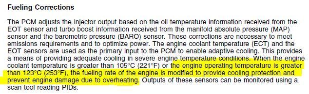

Mark - I've never noticed the discrepancy in the PC-ED Manual until now:

Thanks Bryan! I hadn't seen it at all. I have the "fueling corrections" section well dog-eared! What page is the higher de-fuel point documented?

Yes, fueling is reduced to try to hold back engine temps at ECT over 221*, EOT over 253*. Mark asked about the fan because multiple factors can trip 100% fan clutch engagement, and EOT being high enough is one of those.
Mark - page 1-33 is the 221*ECT/253*EOT derating language (second pic), the first pic is from a chart on 3-11 as part of the pinpoint tests of concern of "engine down on power with no CEL". I wanted to type 235 for oil but that seemed wrong, I searched in the wrong book and 260* popped up. Weird.
