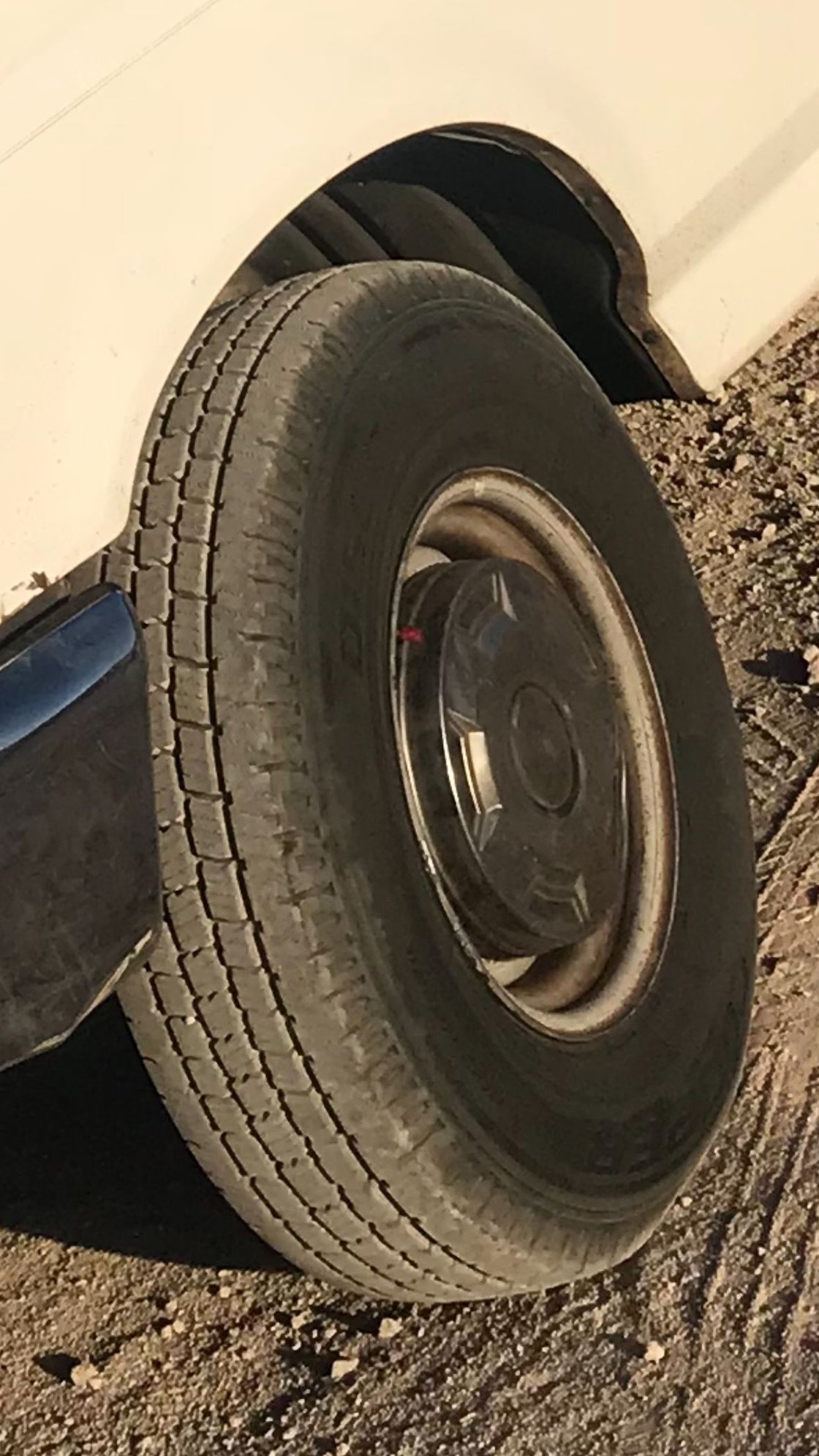

Hey guys. I need some help with my 1996 F250. Maybe i'm just stupid but idk how to remove the hub cap lol I need to get access to the lug nuts but can't get the cover off.I included a pic of what my wheels look like. If someone could explain how these hub caps come off that would be great. thank you

Those caps just pry off but they are really stuck on get the longest prybar you have wrap a rag around the end And pry it off. Their are ridges on the inside that hold it on if you line your prybar up with one it will do less damage to the cap, but either way it will come off.

The original lug wrench has a slightly bent slim tongue on the end of it to remove hubcaps.
