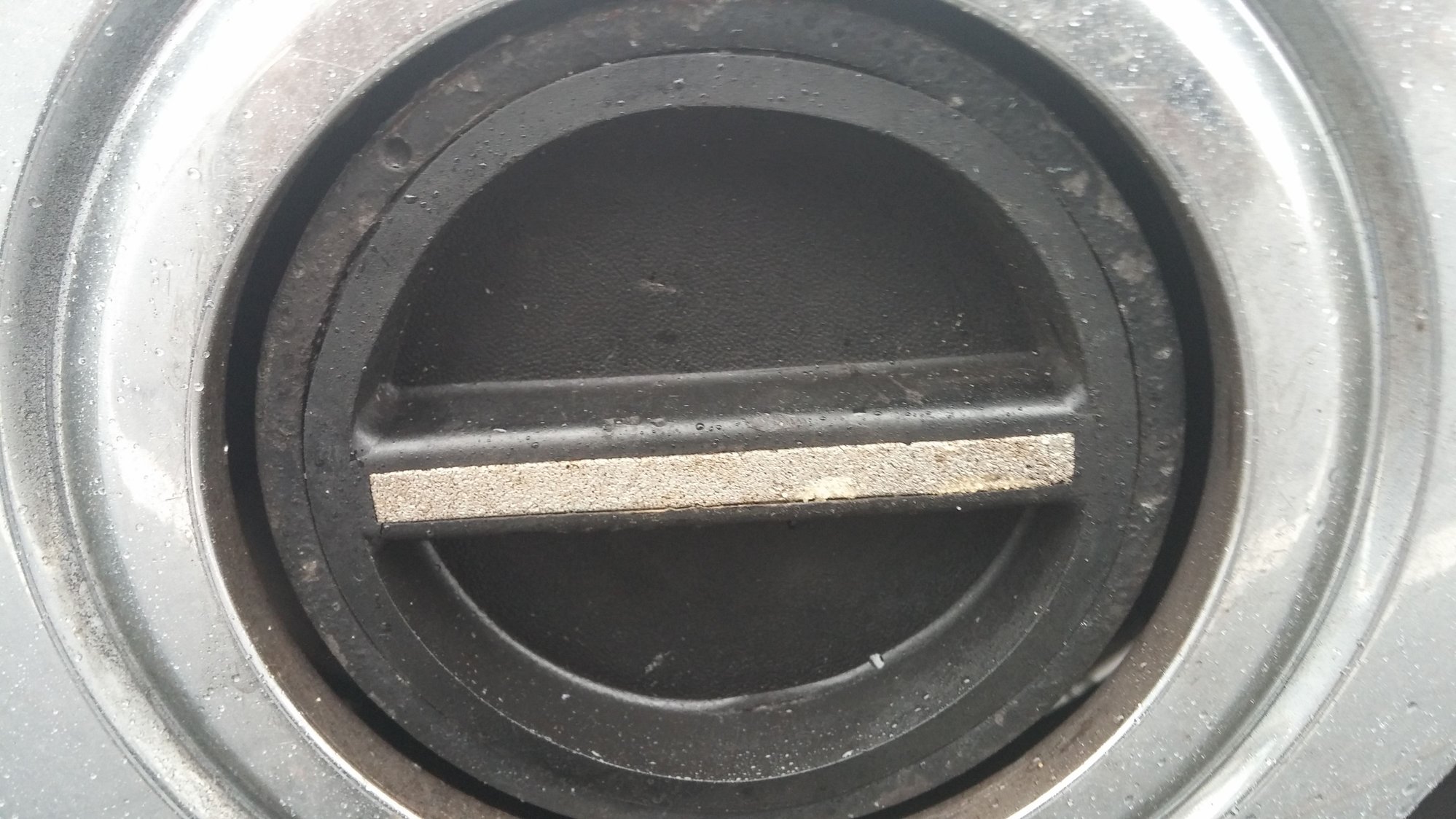

I have seen pictures of other hub lock cups that have Allen bolts to remove - mine do not have any fasteners - how can they be removed - do the just pry off?

take off the center cap of the wheel that covers the lug nuts. Then you will be able to see the retaining ring tangs sticking out that you need to squeeze together. After you have that out, start wiggling.

Thanks, so will just the center section in the picture come out or will the entire assembly visible in the pic?

Got it now - saw another video that showed this style of hub - thanks!
