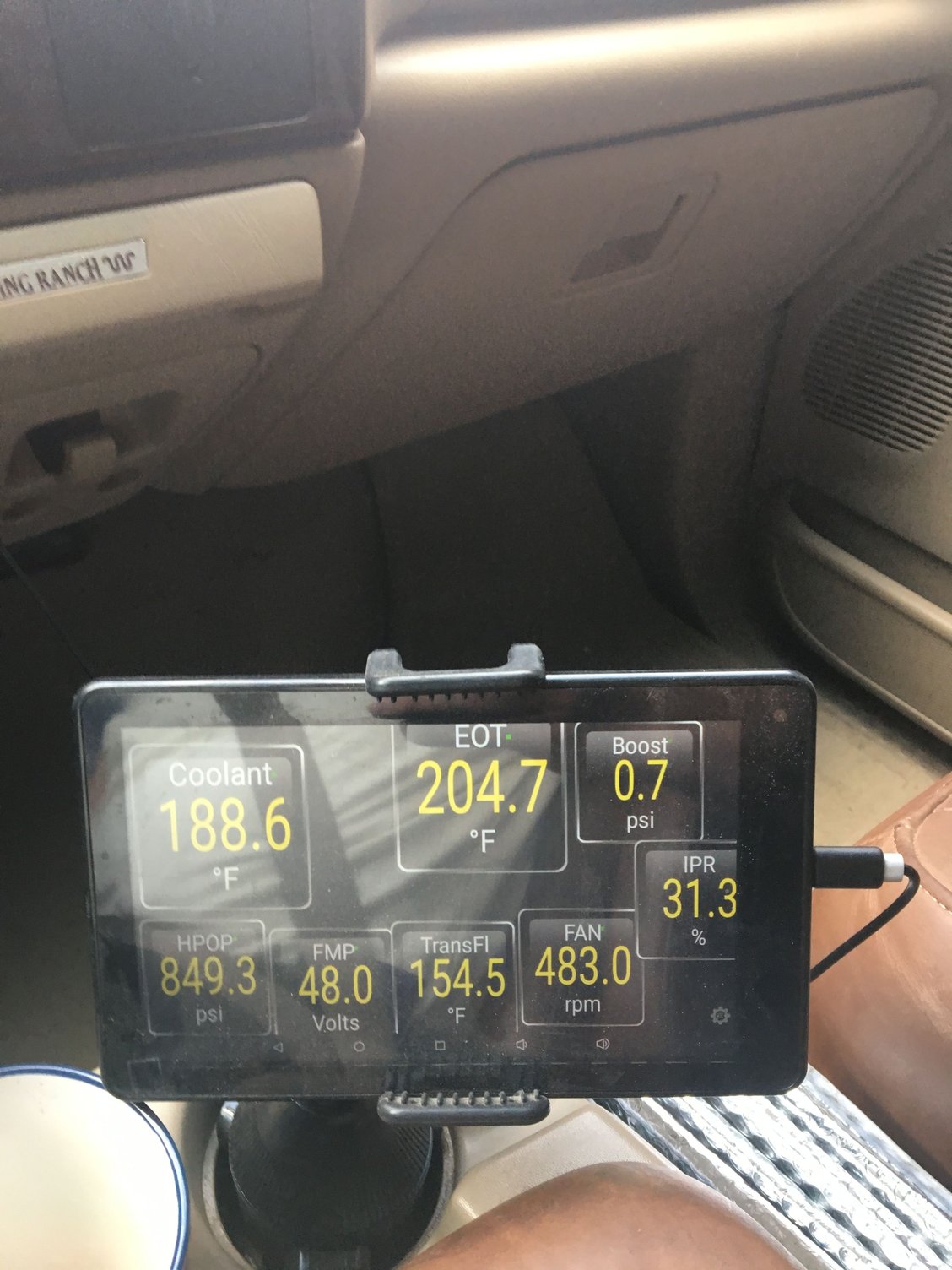

This morning. After 30 min at hwy speeds. 2006 f250

Might be time to backflush the cooler. If it’s not that old it could still be salvageable. I run a 200* mishimoto thermostat and run 200 ect and 206 eot at times but I know I have a 8-10* spread with a 192* thermostat. So mine time is coming.
