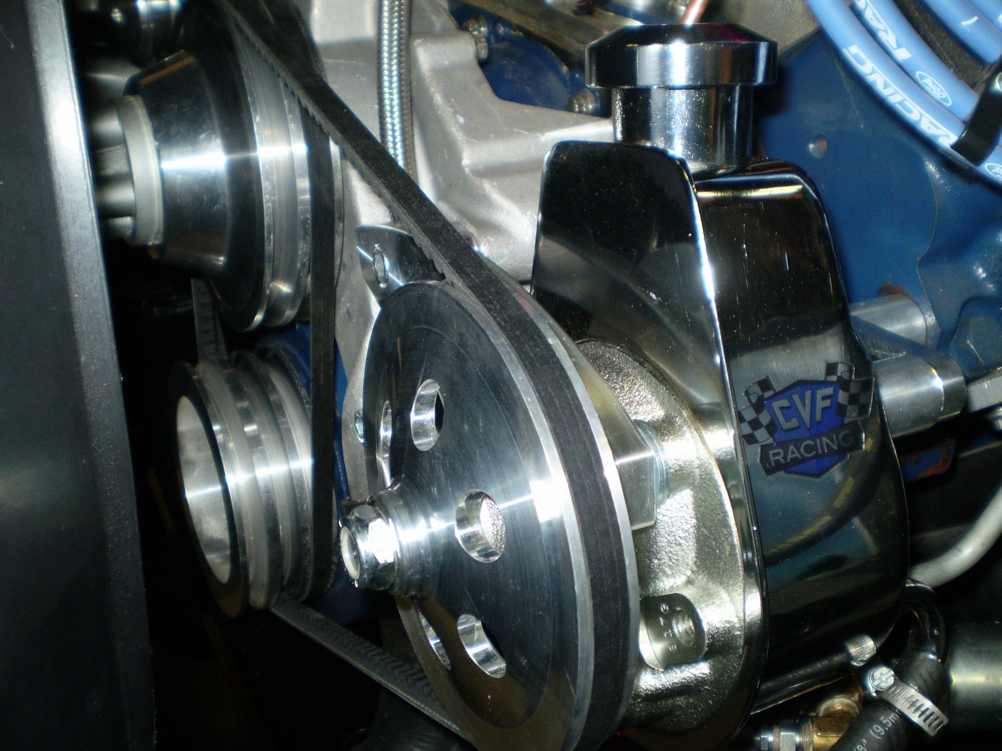

Just did the Saginaw conversion on my 76 F-250 4x4. Everything went well, installation, filling and bleeding. All worked well. Now all of a sudden when I try to steer either way the pump pulley momentarily stops causing the belt to squeal. Checked belt tension, tried re-bleeding system, can't figure it out. No leaks, fluid does not have any air bubbles in it, all steering components are new, turns freely when tires are off the ground. What could be causing pump pulley to stop when turning steering wheel with truck running. Bad pump? Got the pump from CVF Racing.

Well, went through the bleeding procedures a couple different ways and still having the same problem so CVF is sending out a new Saginaw pump. Will update when new pump arrives and gets installed. Here is how the set-up looks.
