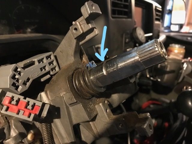

Column spring retaining ring re-install. Good luck! I had to make a tool. I'm sure Ford makes one too for a couple hundred bucks. I went to DumbDumb Depot and got a 2-1/2" x 1" nipple and a fender washer. Use the steering wheel bolt to compress the spring and get the retaining ring back where it belongs on the LOWER cutout. The arrow here points to the INCORRECT cutout for the retaining ring. Your clock spring will not go back on with the ring on the upper cutout.
This spring is a mother****ing bitch to get back in. It's do-able but you need muscles. That is all:
