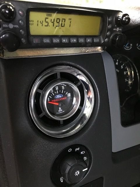

Since the sender is simply a switch I doubt the information on pressure is available. I just went old school.
