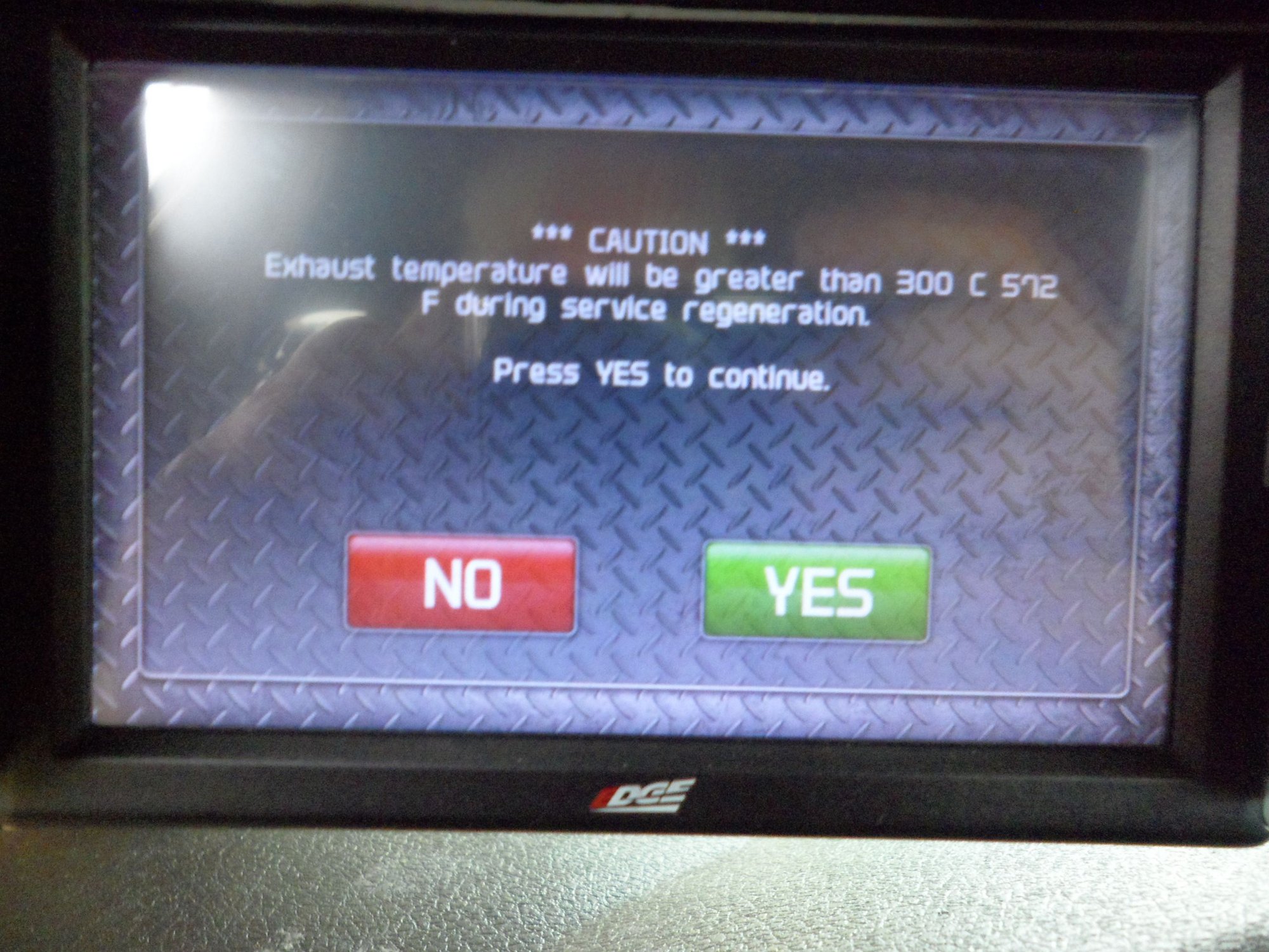

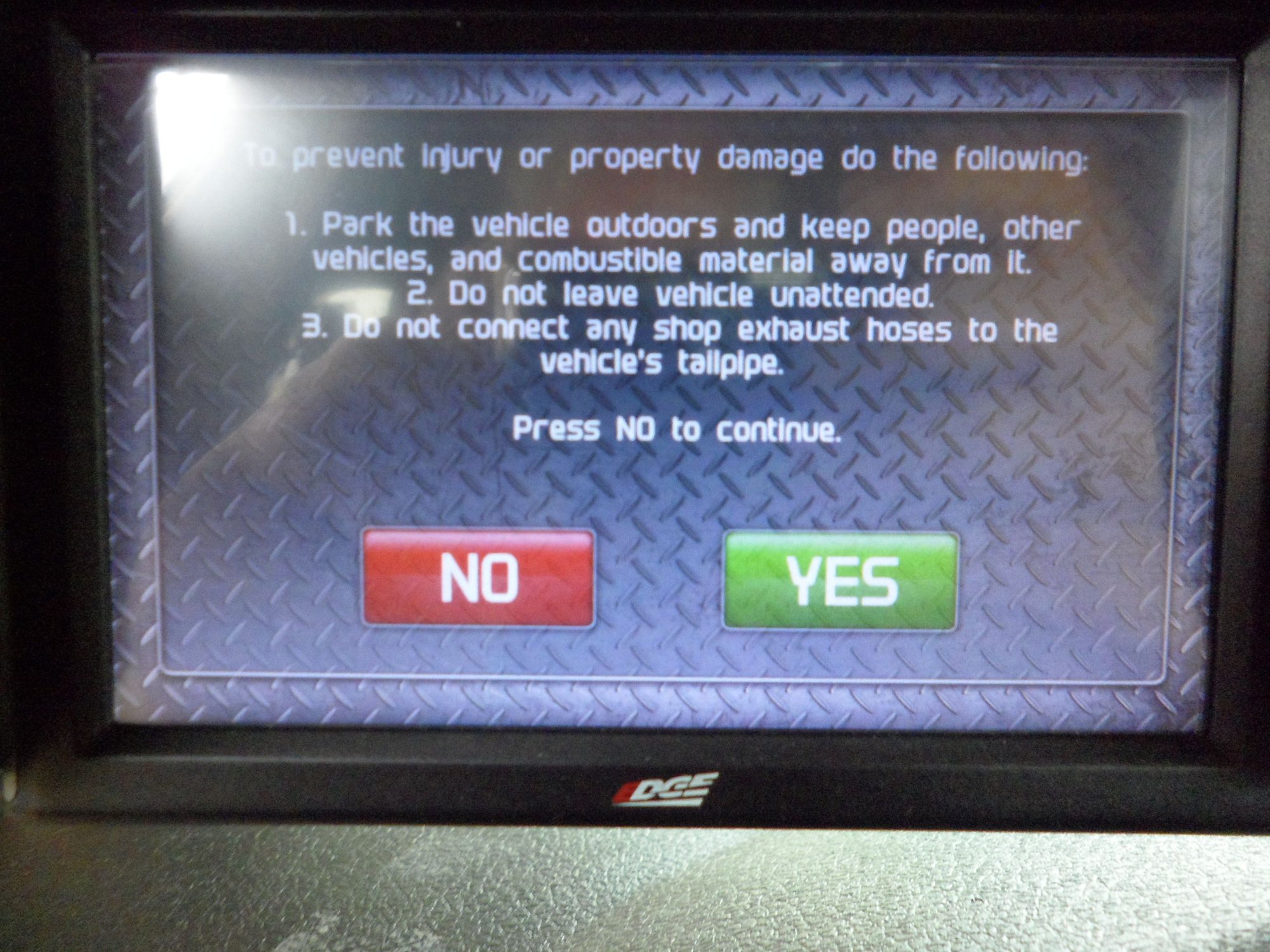

Here are some photos I just took from my 2015 with CTS2...My truck recently did an active regen and was not up to temp, so could not progress any further than these screens.
