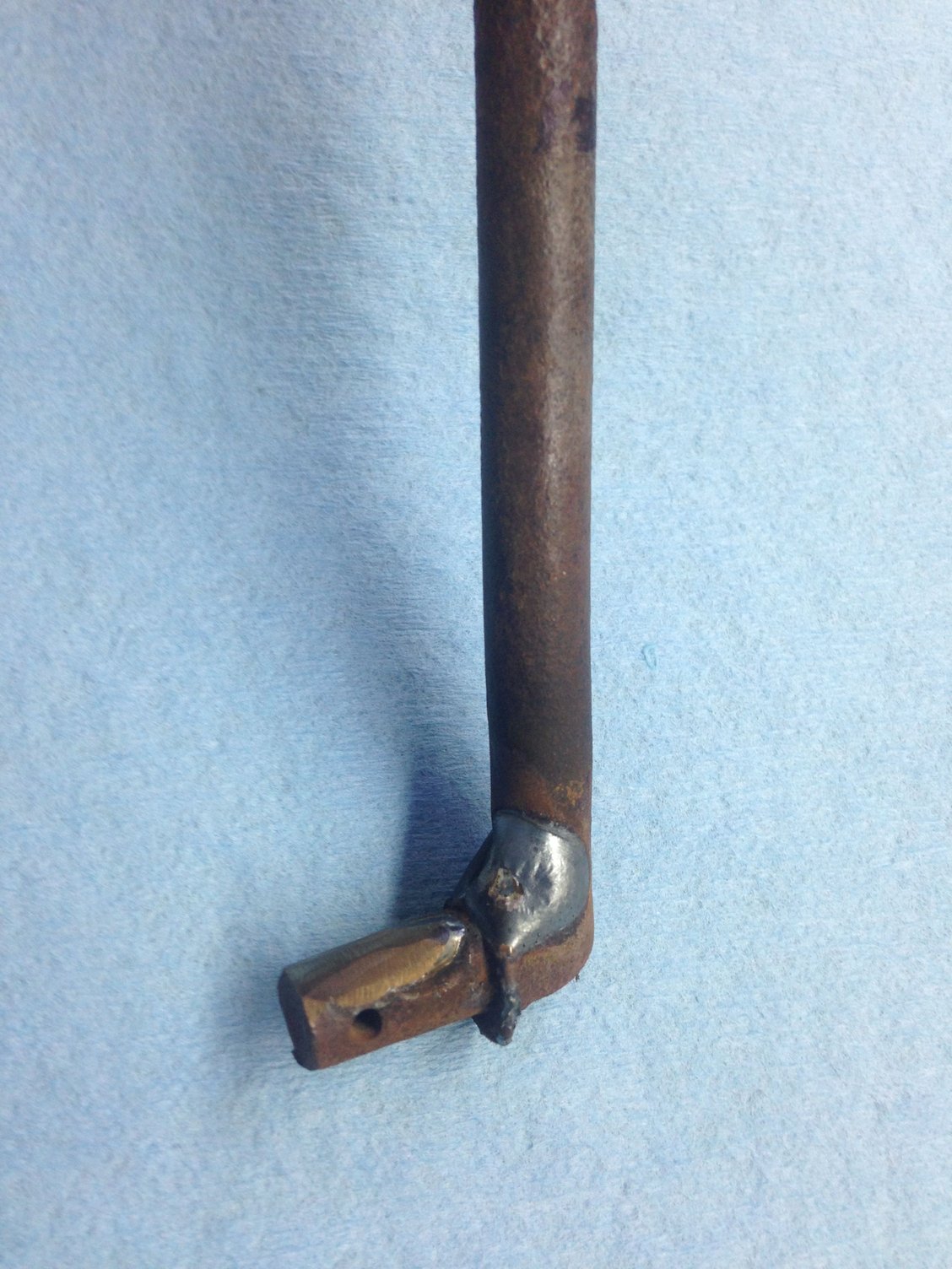

Here is the clutch rod straight as a string now and welded. I put it on and it works fine, but the clutch still does not come back as it should. I think I am going to find a place to add another spring to pull it back up. Hope pic comes through.

The clutch pedal should do the opposite when you take your foot off of it as it does when you put your foot on it. The pedal and rod and linkage should all react to the clutch diaphragm itself. The diaphragm is spring loaded and wants to return to it's resting position (engaged). When you raise your foot the diaphragm should push the throw-out bearing back to its resting location. The fork, being as it is attached to the throw-out bearing, should also be pushed back to its resting location, which in turn pushes the bell-crank and that should move the linkage back into place. The linkage is connected to the pedal so it has to move when all of this happens.
You might want to take a good hard look at everything and make sure you've got it all connected properly and that everything moves in correct relation to one another and that nothing is worn out causing this to happen.
I just removed my clutch pedal return spring on my truck and the clutch pedal still does everything it is supposed to do. The spring is just there to assist slightly.
