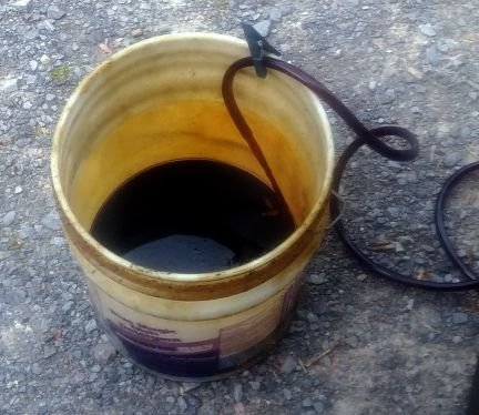

I added a Tru Cool 4379 to mine because it's what I had on my Super Duty and it worked well there. They claim it's a low pressure drop unit and ok to put in series with the existing coolers on a 4R100. I did change my fluid after plumbing the new cooler in and had good flow through the whole system. I tow a 10k travel trailer and haven't seen a trans temp over 190° yet. I expect the 6.0 cooler would deliver better performance but this one is getting the job done. I know Dieselsite has them and I'm sure other do as well...found a few on Ebay.
