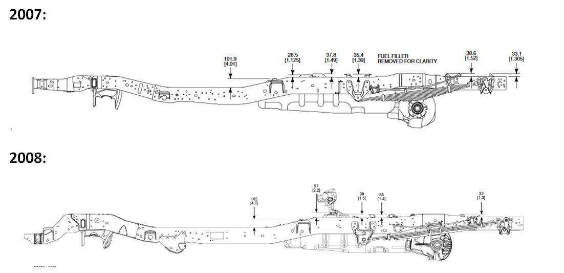

Originally Posted by DieselBeast01
The mounting points have never changed to my knowledge as these trucks have had pretty much the same frame from 99-15.
The front frame horns were lowered in 2008 to remove the crash bar. The horn end has what appears to be the same/very similar bracket IIRC, but the mounting points did move. The whole front facia was redeisgned so it's not normally noted until you try to do a 2008+ or 2011+ front clip swap on an older truck and have to use a bracket to move the bumper.
Ah, so they have changed.
You can see of the left hand side the front horns really dropped in 2008:
Love my Ranch Hand full replacement:
That diagram was super helpful. Now I also have bumper envy. Thanks.
