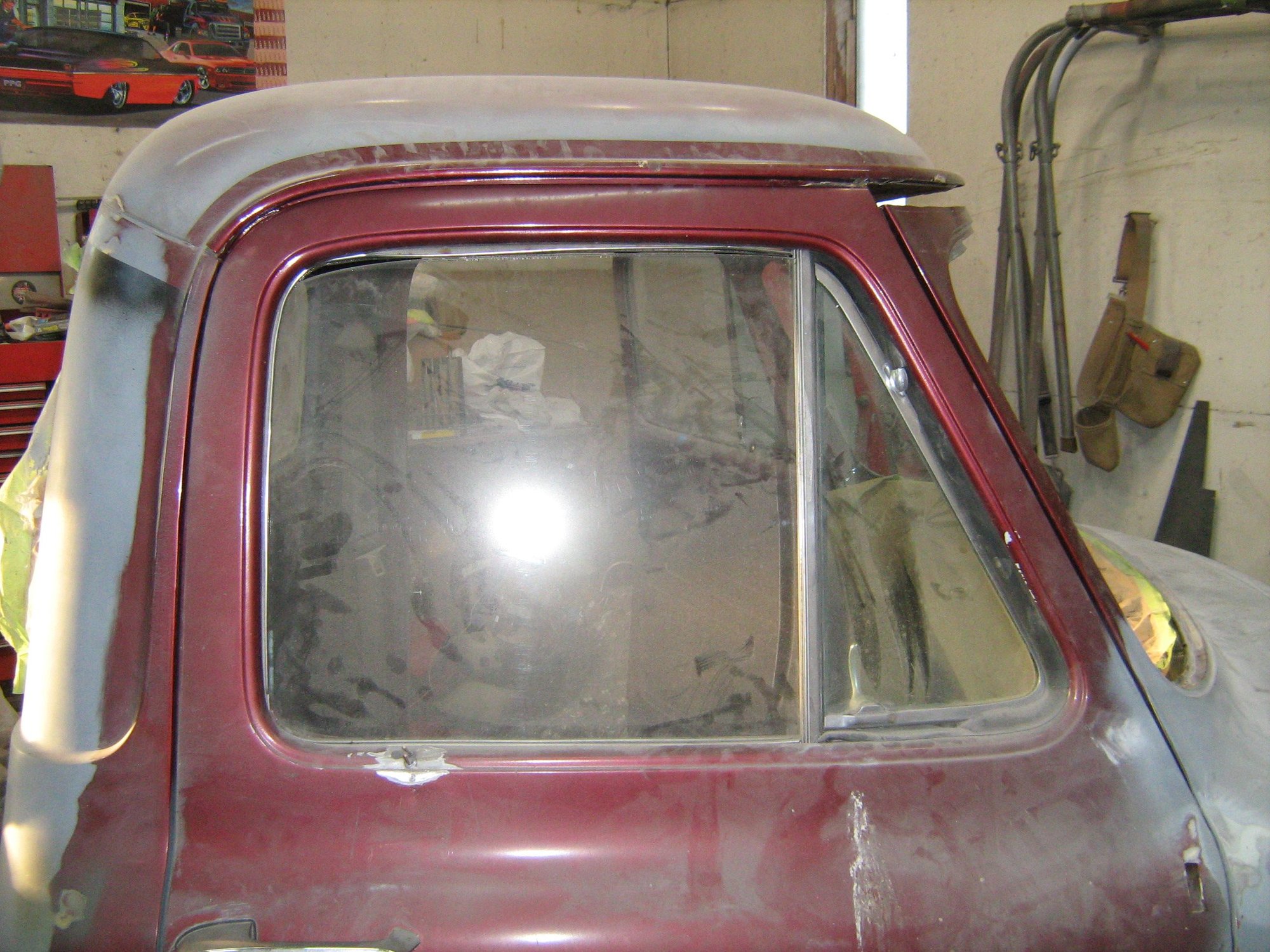

Forgot to take the camera out this afternoon but had these snapped
Cut this door the same less the complete cut here .
Tried to get a similar angle for comparison .
Not immediately noticeable but that's the idea . It will look and " flow " better to me if to no one else . Plus allow me to pancake the hood slightly and not exaggerate the backwards slop of the drip rail .

I'd like a pancaked hood but that`s way above my ability.

Well Morris I keep saying these mods have to come to a stop or this truck will never see the road . Then I sit on a stool with a frosty in my hand and think " am I going to be completely happy if I don't do allot of these " and my answer most times is no . Of course the fact that I'm not paying anybody to do it does help and the fact that my time estimates ( also the time I will not be working on other peoples stuff making money ) seem to be extremely frugal . The hood pancake along with many others are still in negotiations .

If I do the pancake it also will be very subtle , probably in that 1.5" range . Again I am not looking for mods that can be picked out easily just a cleaner ( at least in my mind ) look that people will know somethings up but not be sure of what .
