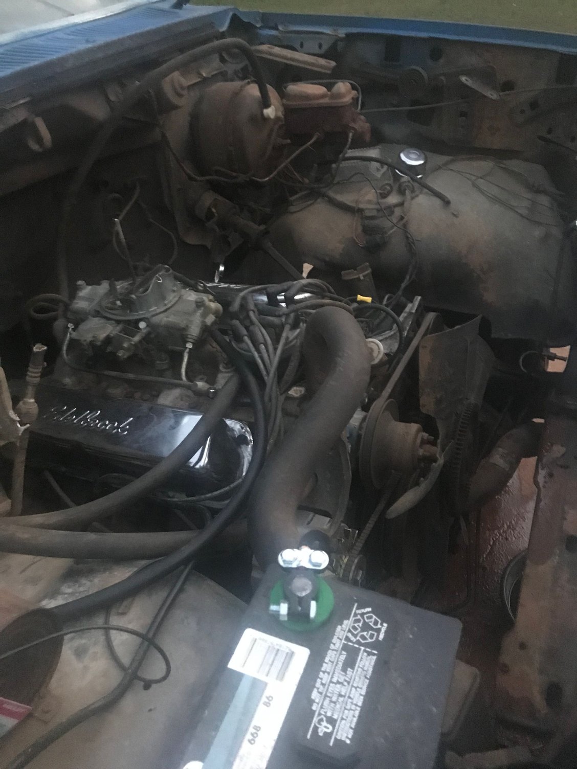

purchased an 85 f150 about a year ago. Solid 12 months of running around. Time to pull the motor, rebuild, and keep things moving. Nasty rear main seal leak, dripping all over tranny. Dropped fluids today, pulled coolant system. Will hopefully pull motor next weekend. Will attempt to document this build and harass all the old heads while i do it. Not really looking for a “fast truck.” More so a well built 302 that runs correctly, is loud as hell, and lets me drag my kiddos to the gas station for a beer run on the weekends.

carbureted. Past owner slapped a Holley double pumper on the motor and claims to have a bit of performance upgrades. Bit of overkill? Don’t ya think? Interested to see what’s actually inside the motor once it’s dug out. Motor has been pulled before, so who knows what little gems it may hold.
If the motor ends up being basically stock, it’s safe to say that massive carb isn’t really doing me any good, right?
