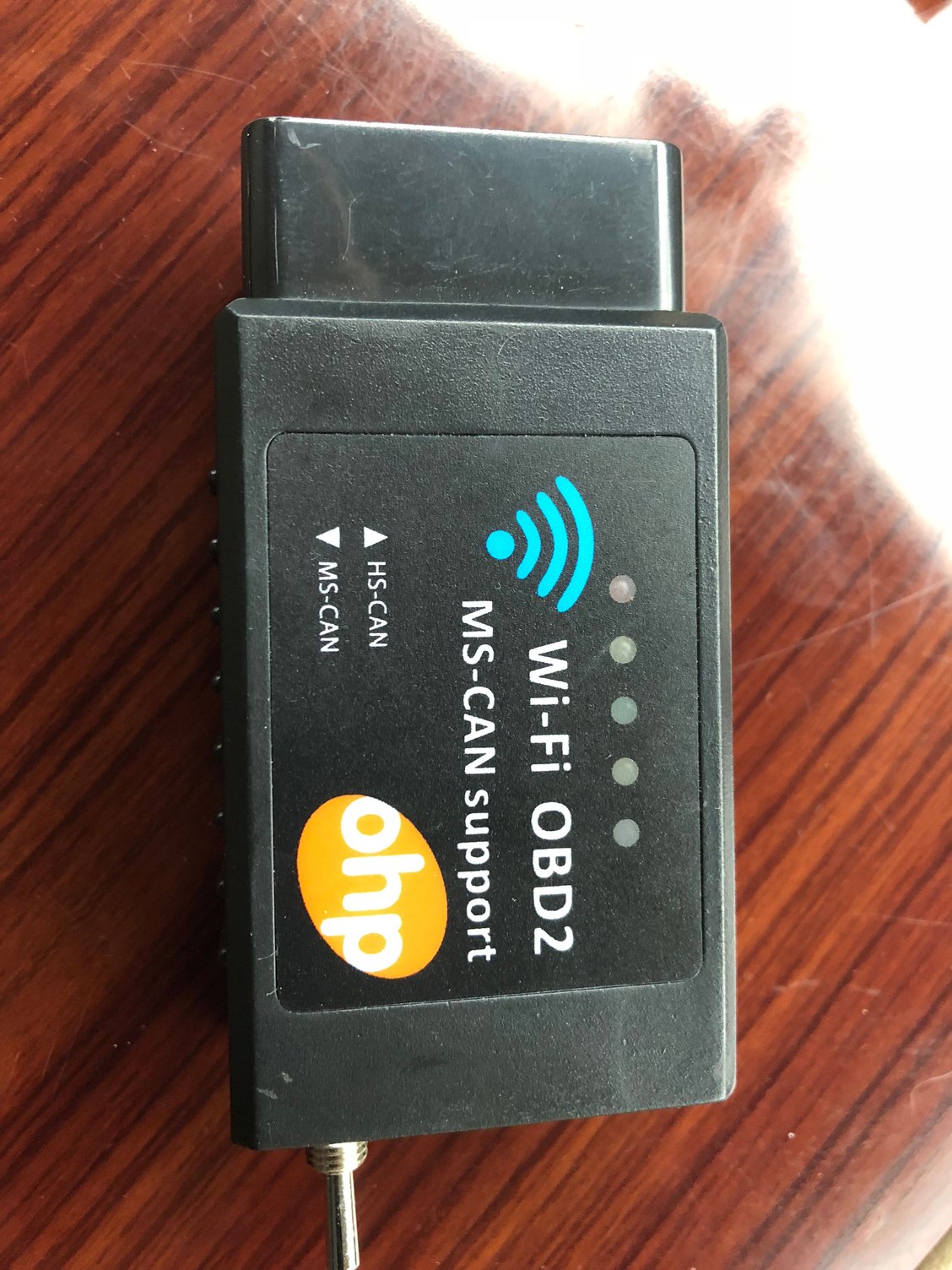

You will need a WiFi adapter for the iPhone. Torque pro is an android OS so you will want FORScan
check amazon and search FORScan adapter.

When you get the right scan tool, post up your coolant and your oil temperatures. It would be helpful to see the values after a good cold soak (12 hrs of not running the engine), and then after they stabilize under normal highway driving.
I agree w/ FiznUKa, get the ForScan software and buy an ELM327 wifi adapter. IMO the BAFX adapters seem to work the best.
