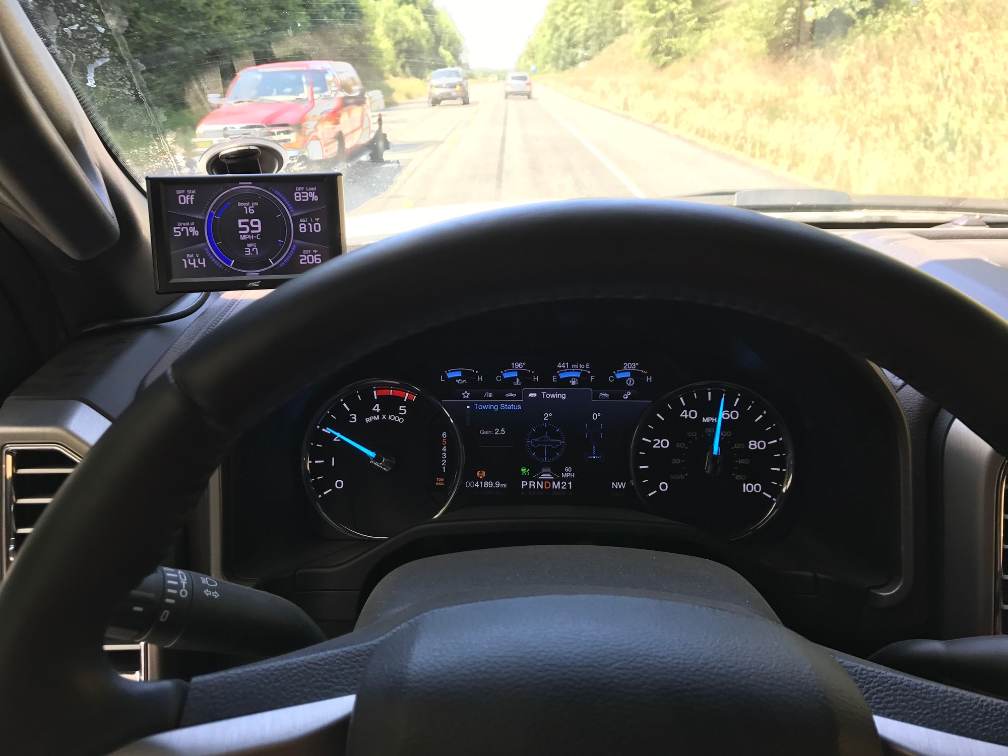

Originally Posted by nuctrooper
suction cup mount isn’t too bad.
Have you found the instantaneous MPG to be relatively accurate? I tired it for a while, and found the readings to be all over the place, and not agreeing with the graph available in the center display.
Old May 12, 2018 | 08:32 AM
nuctrooper's Avatar
nuctrooper
Joined: Dec 2005
Posts: 906
Likes: 107
From: Seattle area
that pic was a while back when I was still working out which data points to monitor. I’ve deselected instant mpg (yes, all over the place), DPF stat (doesn’t work), DEF level (just fill every 5k miles, doesn’t change day to day), and added DPF gpl (much better indication of pending regen).

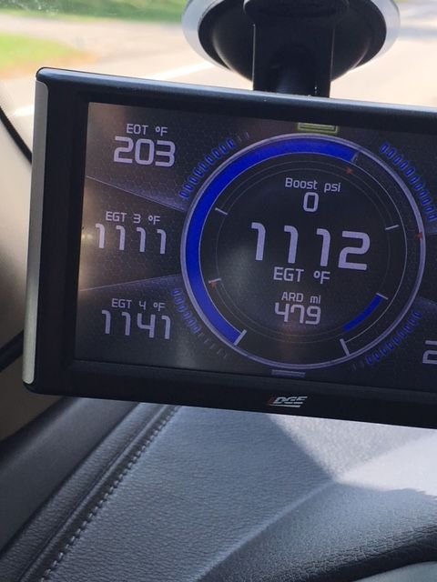

Did that today and it worked !!!!! Thanks for the tip . I got to see what happens during a regen today . It started at 94% and only went down to 10% on the Edge . On the truck display it went to zero and the Edge showed 18% and it was still in regen mode down to 10% . Gas mileage went to crap and egt's went way up .
