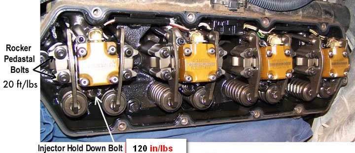

Tomorrow I will be removing the valve covers to test the injectors. Also need to check the manifolds for leaks. Anything else I should be looking for?

120 in/lbs is OEM spec for the Injector Hold Down Bolts. Some may disagree with this approach; however, I increase the torque on them to no less than 130 in/lbs and no more than 140 in/lbs. using an inch pound rated torque wrench. You may want to consider the 50 cent mod as well.
50 cent mod?
