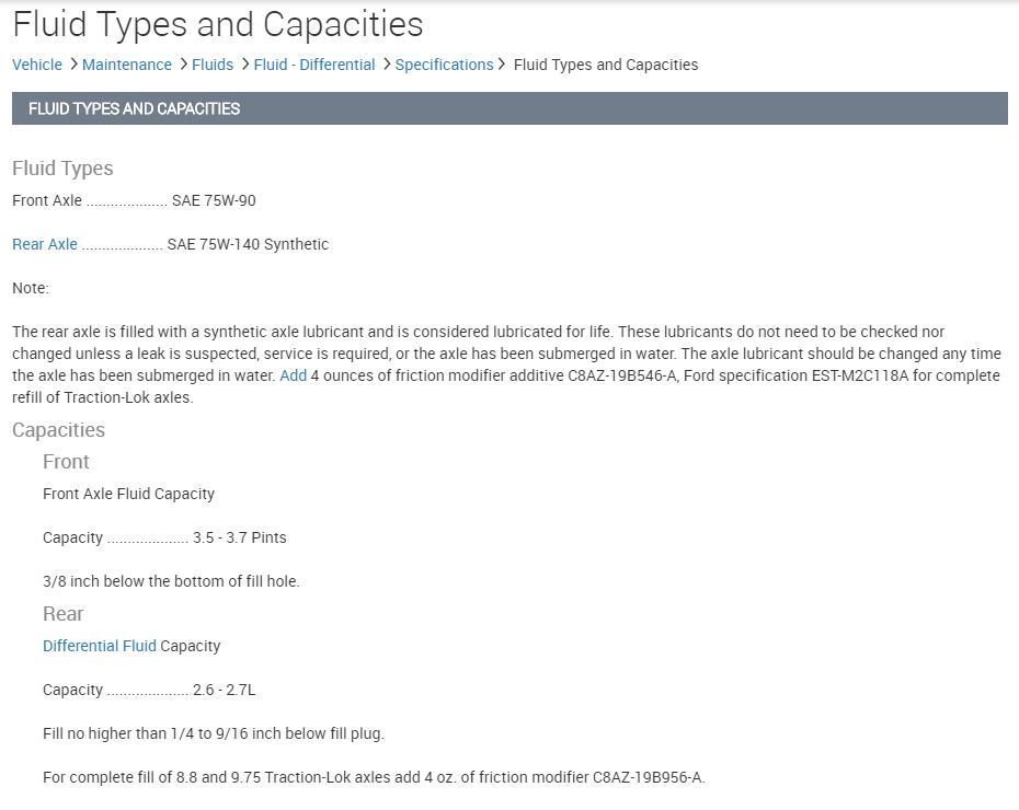

Just as a side note, since you'll be on your 3rd diff:
I had my rear diff oil replaced, and it was over-filled. The rear diff started to shudder on light acceleration when turning after driving for 20 min or more (foaming). Changed it again, but the proper way, issue gone.
