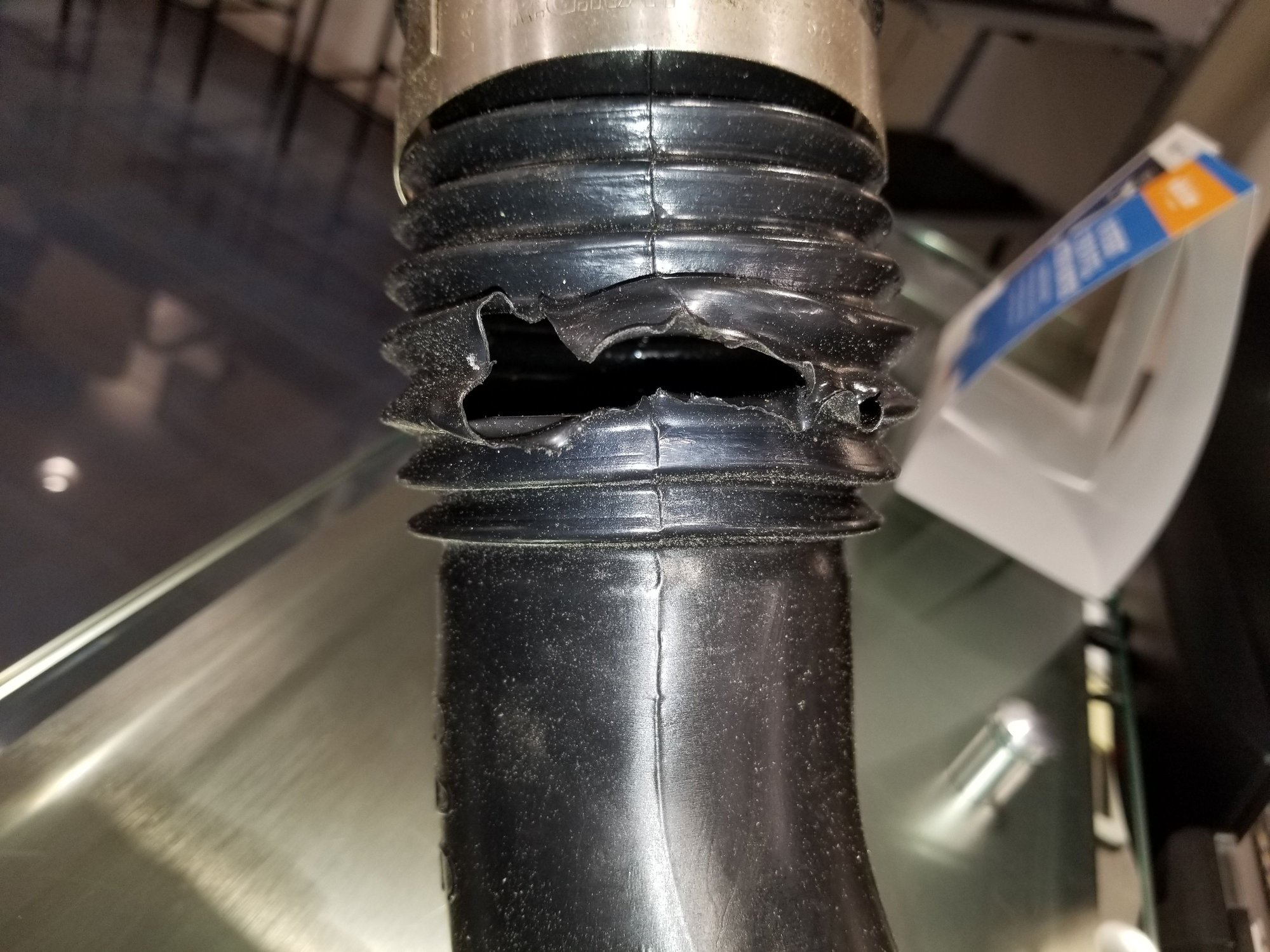

On a recent trip pulling my 38 foot fifth wheel I blew the hot side of the turbo hose off (Blue- Hose) put it back on with a good cleaning and alittle hair spray then still noticed a loss of power so upon arriving at my destination I put it the shop they discovered a bad connector at the VGT solenoid, and split in the Cold air hose that routes under the Air Filter. All was good the truck seemed to run fine.. But wait, on the return journey home less than a hundred miles away the shop where it was fixed $500 earlier, the new cold air hose (CAV?) blew apart I mean blew a hole in it. I have watched my SG II and noticed at about 23 # of boost it switches to a negative # as high as -13.4 Any thoughts?

crappy plastic hose everyone gets rid of... you need to upgrade to the metal ones... you also need to reprogram your SG as you shouldnt be seeing a negative number on the boost readings.. mines been outputting 29lbs on the mechanical gauge i have.. not blowing off any tubes... and metal up and down pipes..

Part of that could be something rubbed the hose to weaken it. Change that to the metal tube AND then even double the clamps if needed. I run double clamps on mine to prevent blow offs... the woman in the car next to me thought I shot her or at least popped one out the window.

heat is the enemy of plastics thats for sure.. but the weakness in the flex joint of the plastic pipe is why we upgrade to the metal pipes... moves all the flex to the rubber boots which are far stronger than the plastic pipe is... in addition that pipe is also baked by all the engine heat trapped under the hood...

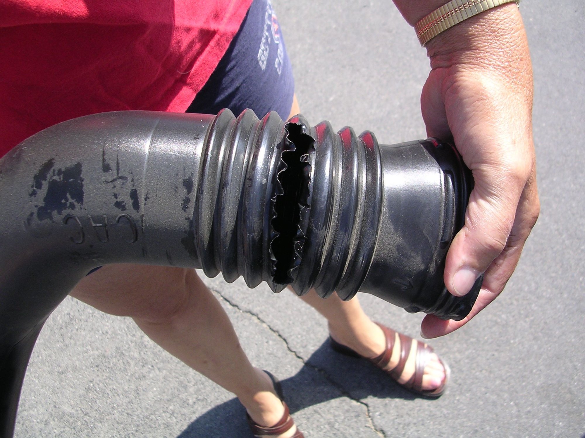

Originally Posted by HTM101
Mine blew out exactly as yours did, in the flex bellow. Truck was 18 months old with 4,000 miles on it. Ford replaced the plastic tube with a metal tube under warranty. The year it blew out was 2005.
David
I found the original photo, taken about 2 hours after the failure while we were at the Ford dealership.
Old May 15, 2018 | 06:06 PM
WatsonR's Avatar
WatsonR
Joined: May 2014
Posts: 6,545
Likes: 13
From: Virginia Beach VA
Wow... right on the seam.
