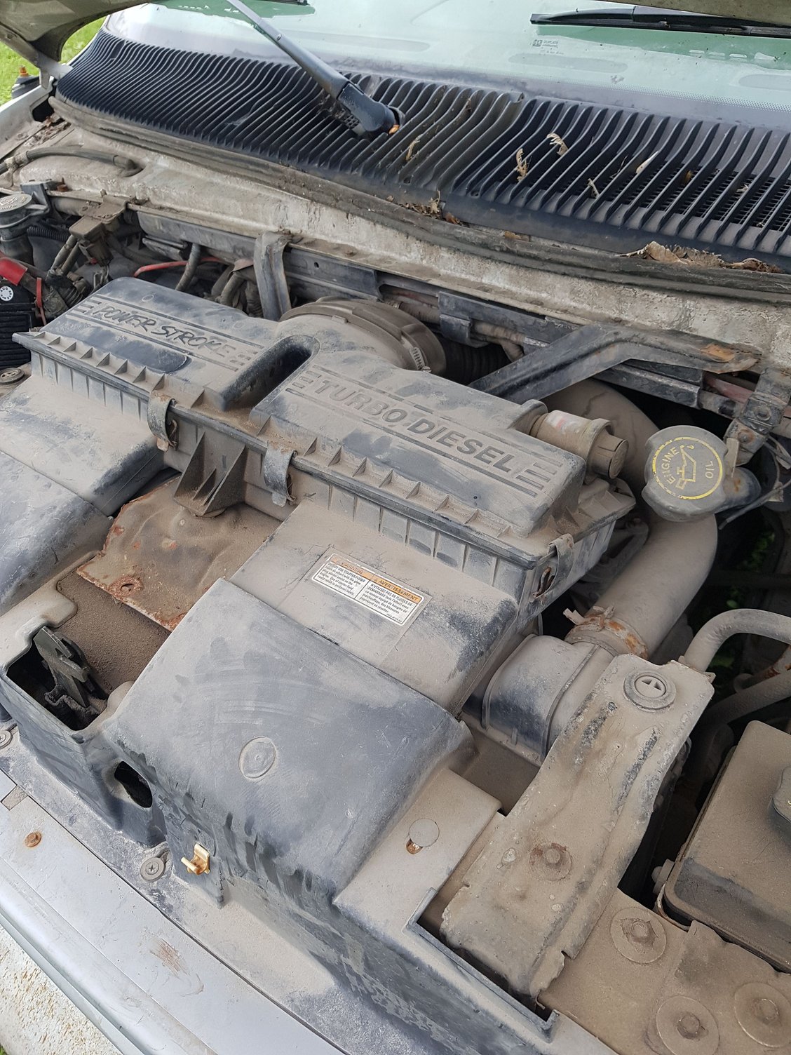

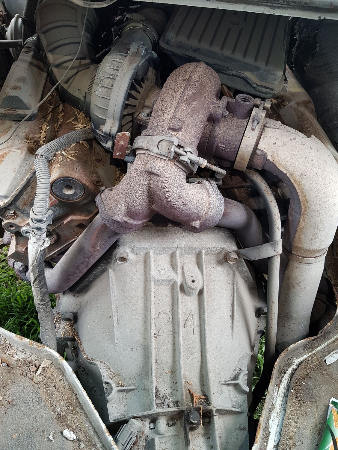

So I picked us this rig on the weekend..
Couldn't pass it up..
But really don't understand what I have here..
Did vans not get built with intercoolers ? Looks like it will be easy to remove with the access from the interior..
I guess its a cab and chassis E450 with an added fiberglass back..
here's a few images.
I paid equivalent to 1100$ US dollars..
And drove it home 4 hrs ...
Kyle
Old May 28, 2018 | 07:35 AM
Walleye Hunter's Avatar
Walleye Hunter
Joined: Mar 2014
Posts: 10,750
Likes: 1,065
From: Douglassville, PA
An E-450 should be cab and chassis, steel tank at the rear of the truck, 4R100 2WD trans. You'll have to switch some parts out to put it into your Ex. The alternator and A/C compressor are probably in switched locations so you'll have to swap your brackets in, your oil cooler mounts (the ends only) are different but I do not know that they have to be changed, maybe, maybe not. It has no aftercooler so you'll need to swap in your spider, the turbo has a different exhaust housing but you may be able to use it if you want to, it's something like a 1.15 AR and the outlet on it might be different size. It is missing the wastegate too. The oil fill tube is on the driver's side VC so you might want/need to change something there, either the VC's or if there are plugs in the VC's you might be able to move the tube over or you might be able to leave it on the other side. It probably has a GPCM so you should be able to leave that part alone. That's all I can think of at the moment.

Any ideas is that's a 4 or 5 bolt compressor housing ?
I'm trying to figure out if its and E or L 99 version..
Since the motor is much new I won't be able to tell by it..
