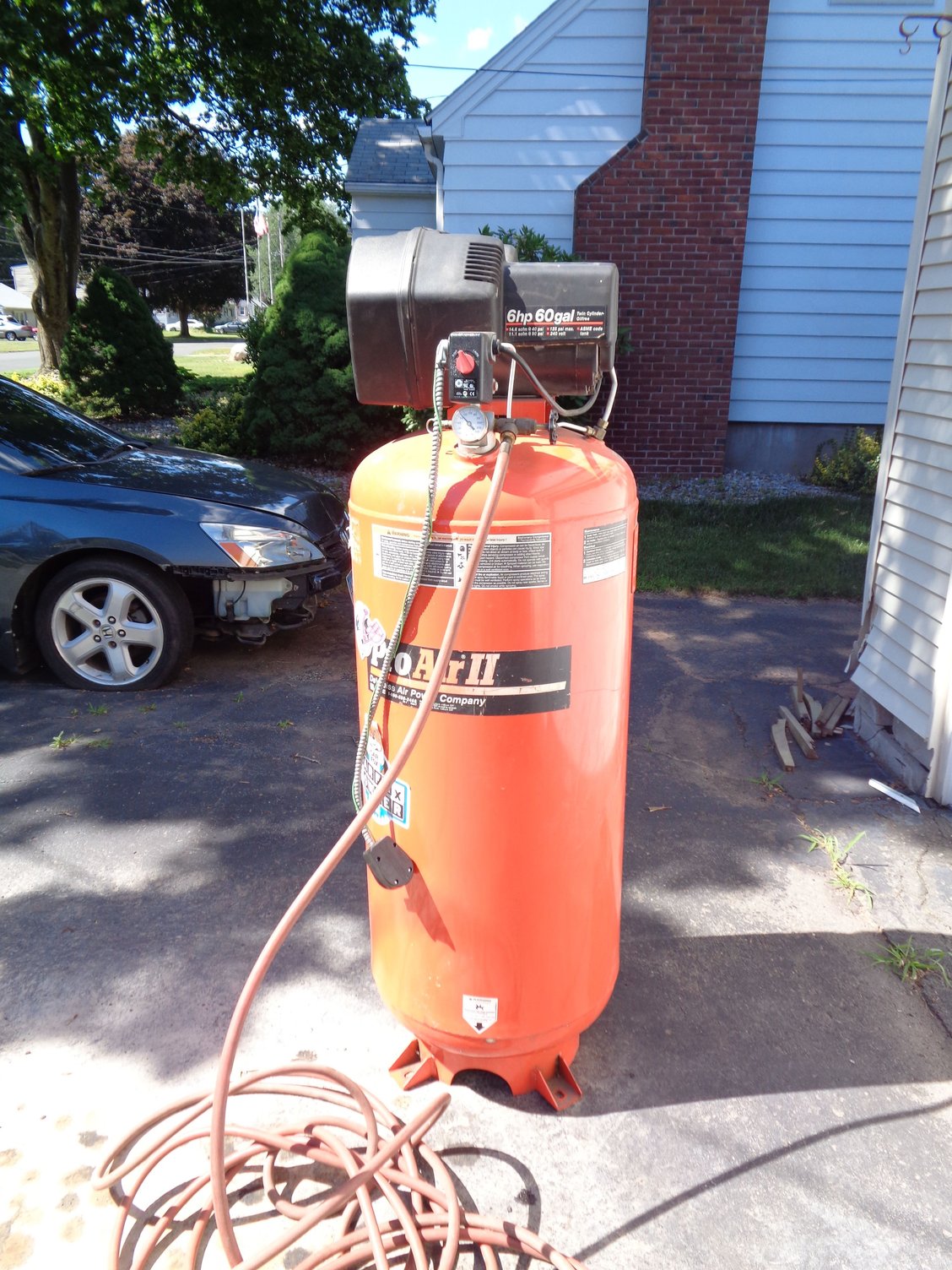

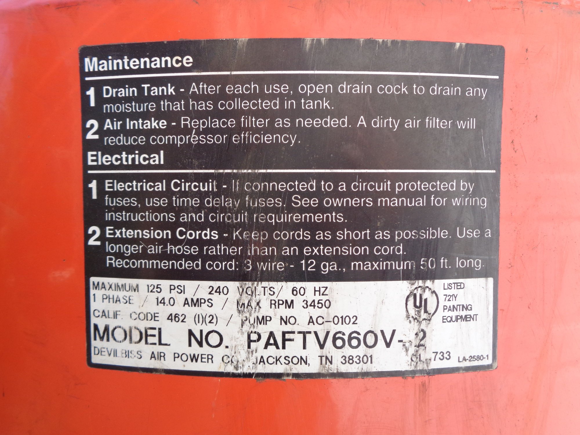

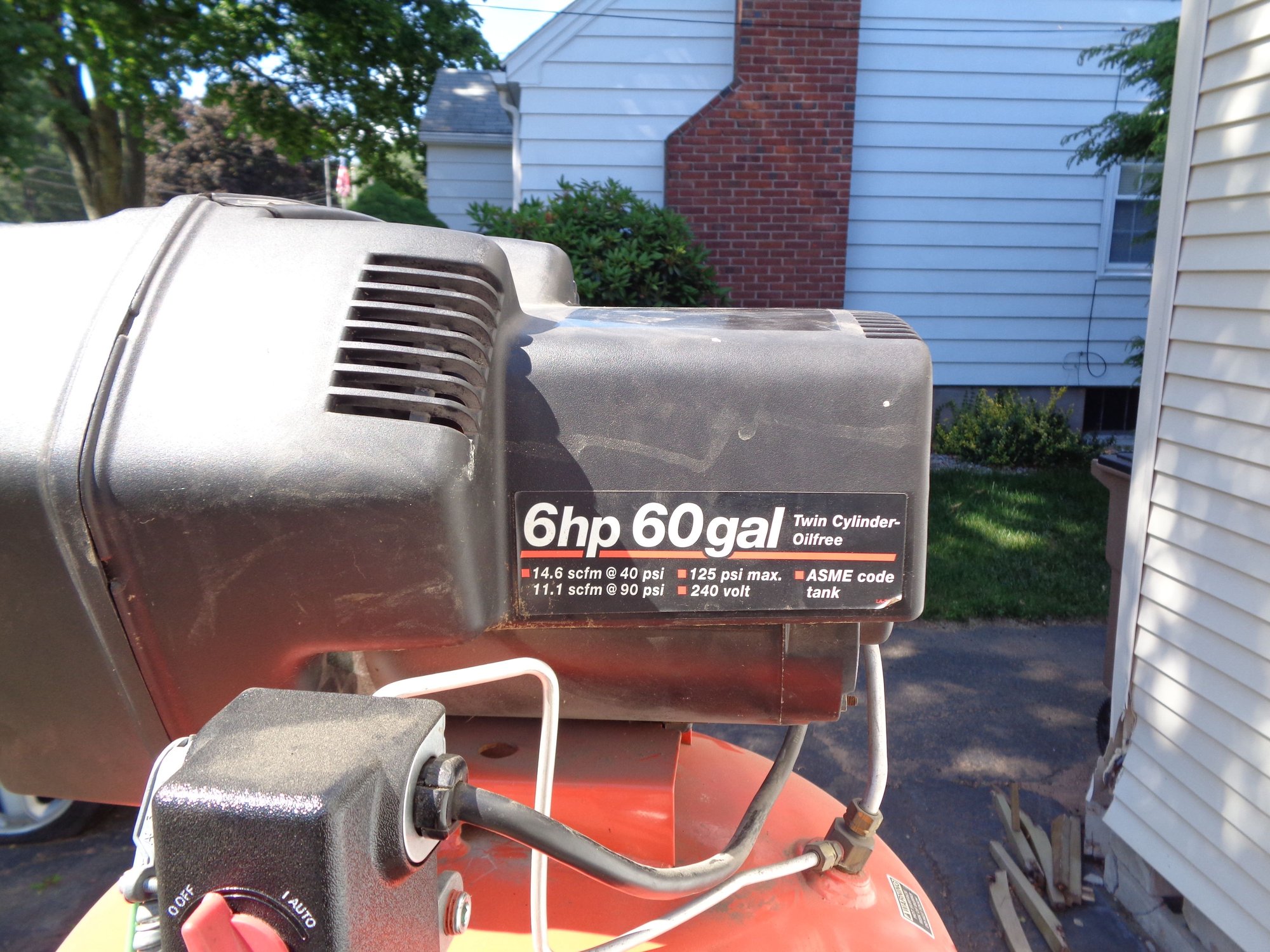

$140 Deal / No Deal? We ran it at the guys shop for 20 minutes up to 125psi. Ran good. Drained clear. Guy has two REAL compressors. Said he got this one from a guy who couldn't pay his bill.
For that money I think I would of gone for it if it was better than what I had.
When looking at compressors you need to know what the max CFM tool you are going to use is and at what PSI. Then you want to add a little more or a lot to the CFM and that it what you want for your compressor.
So if that tool uses say 10 CFM @ 50 PSI you would want your compressor to make more CFM or the compressor will be running nonstop and that is not good for the unit.
(edit) I did see a CFM rating in the first picture for that compressor but it dose not make it bad for a home garage depending on what you need to do.
Just something to keep in mind when looking for one.
